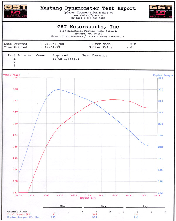

Another E85 Evo 10
2008 Evo 10 GSR
Mods:
Custom catback with neck down under the rear of the car (no rearward visable muffler)
Test pipe
Stock downpipe
Harmon intake
DW 1000cc injectors
Walbro fuelpump
Inline fuel filter
Crushed OEM BOV
GST Boost pill
GST Custom dyno tune
E85
346whp / 369wtq
Pretty good power with not many mods. I think there might be a slight boost leak somewhere so there might be some more to gain after finding that.
For reference on our dyno:
Stock 03/04 evo = 190-210whp
Stock 05 evo = 210-215whp
Stock 06 evo = 220-230whp
Stock 08 evo = 215-230whp
Stock 09 Ralliart = 190-199whp

29psi peak

that mountain of torque looks like fun

Graphs look great, and I bet it is a ton of fun to drive. Congrats.

Great numbers especially considering you didn't go with an aftermarket O2 housing pipe. That would have added another $600 to the cost factoring in parts plus install. I wonder how much hp extra it would have made w/ the aftermarket 02 housing pipe.
