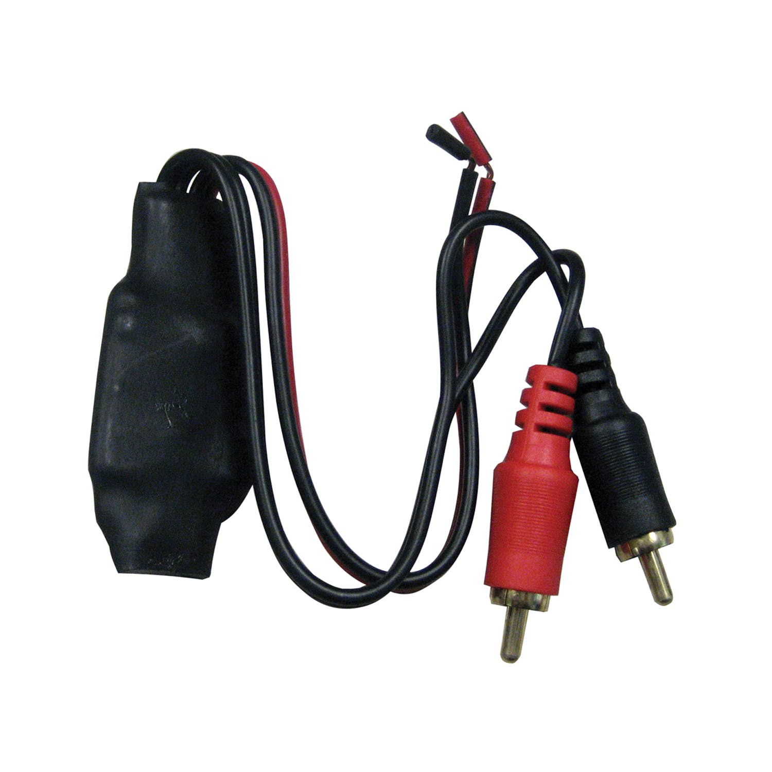

You could just get a bluetooth adapter and wire it into the RF harness if you're ok using your phone. The RF amp weighs about as much as an aftermarket HU does and the weight of the amp is low, where you want it.
http://www.amazon.com/Milennia-1135-...dp/B00BYGEVA4/
Just grab the left/right line in for the amp and wire some female RCAs or just cut off the male RCAs on the adapter and hardwire it.
