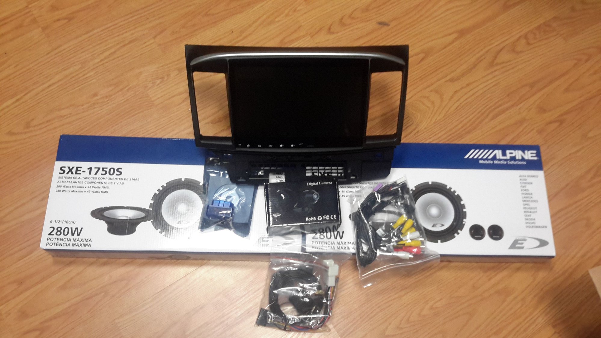

What's up everyone !!! My evo has the non navi rf head unit. I am a bit disappointed on the infamous RF premium sound ( if thats what you call it ) ... So , I started researching here and thankful for all that put in the time and effort to advised everyone regarding the sound system of an evo !!! So , i started ebaying and ran across a 10.2 inch android quad core touchscreen . There's not a lot of videos regarding this item besides a russian you tube in which I cant understand ... The features are too good to pass up and more than half the price of a name brand double din navi aftermarket head unit.. Now , the bad news .It doesn't come with a cd player .I haven't played a cd in years.As far as for myself , it doesn't affect me ..I mostly listen to pandora and music on a thumb drive ...Just in case , anyone thinks of going the route that im going through with the stereo ... At least , there will be a reference ... I don't mind being the guinea pig since I've always have replaced / installed all my stereo equipment on all my previous cars...
So far , I've recieved the head unit, dvr video camera , and obd/obd2 bluetooth for android .I'm waiting on some other parts to come ... I will be posting my progress with my install and update the experience of this unit ...
Im waiting on
Back up video camera
Axxess mito 03 for steering control
I will try and test it out once i recieved it ..
If mito 03 starts acting up like the rear speaker or sound cutting on the rf amp... I will be installing my spare 5 channel amp from previous vehicle. Which i plan to do anyway once I get more free time ...
I also ordered an amp kit , spacer adaptor for the front and rear speakers for my future install...

This unit is a plug and play with the axxess mito 03 ( with a little of soldering or use of butt connectors ).. The ebay seller has something similar to an axxess mito 03 for a $100 more ... I didnt realized it until it was too late ... Please bare with me , as I'm also excited to install it .... I will try my best to take important pics of this install .

Ok , I finally installed the android car stereo with the back camera . I will be posting pictures once i get acquainted to all the features. I just finished about an hour. One thing that may help people doing an aftermarket car stereo ... I have 2015 evo mr . The axxess mito-03 does work on the RF audio system ( as far as my experience )
. It was cutting out the volume in and out for a bit and I was trying figure out why ... Then I remembered that I read somewhere on this forum that the factory bluetooth uses the sound environment to control the volume of the stereo ... I disconnected the bluetooh plug behind the glove compartment . And the cutting in and out stopped ...
