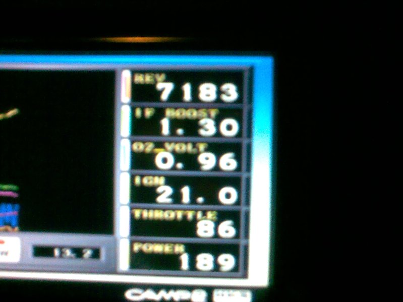

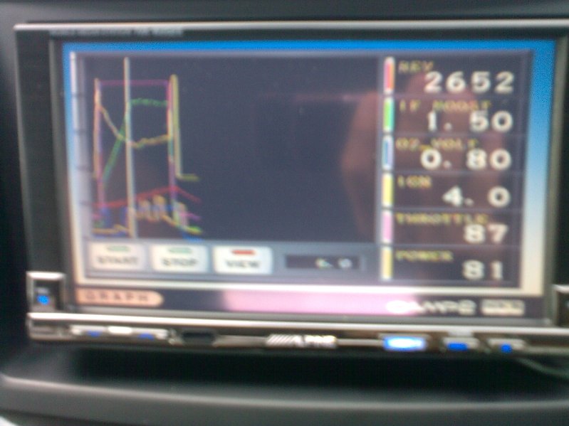

I'm beginning to think the JDM 10's have a different pill in the boost assembly then.
You seeing more boost with more than 100% wgdc I can't explain though. I've tried it on 6 USDM 10's so far and none of them increase boost after 100% wgdc.
Can you post up a screenshot of your logger?

2 screenshots of my logger
7000rpms 1.35 bar .. stock exhaust and cat
2nd 2500+rpms 1.5bar

Gunzo, you have the wastegate mod though, don't you?
at 7000, with the wastegate mod, and stock bcs I am hitting 18.5psi in 3rd gear.

Thanks for the log! Hopefully we can find that 100% WGDC cap on the USDM cars so they can boost more without upgrading pills.
