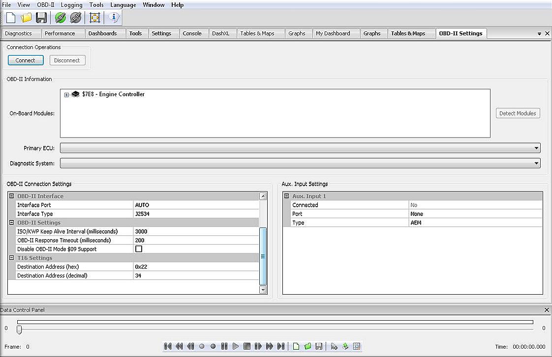

i changed my pc and now pcmscan stopped working!! here are the settings i have, should i change anything?
