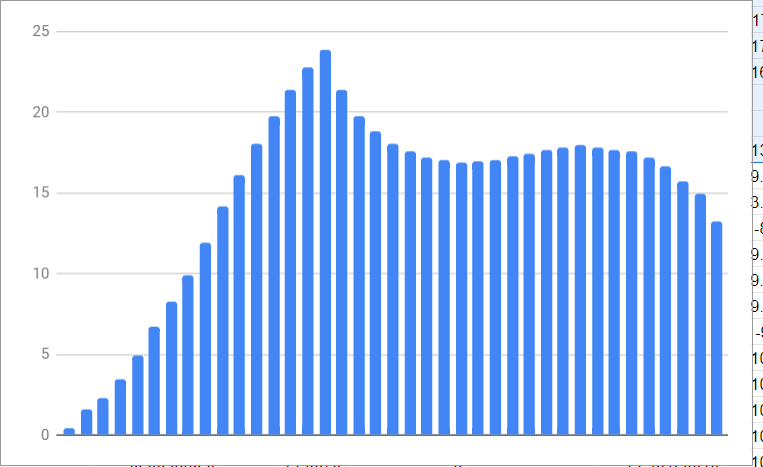

Hey everyone, I'm in the early stages of tuning my evo and am noticing in my logs that I usually hit a peak boost of ~25 PSI at 3500 RPM then it very quickly tapers off to about 15 PSI for the rest of a WOT pull. Is a drop that significant expected? Should I be getting a boost leak test?
I haven't changed anything related to the WGDC or any boost solenoid maps. All completely stock. I've attached a picture of the boost curve, am I wrong in thinking that because it's able to maintain that 15 PSI fairly stable that it isn't a boost leak?
Thanks for all your help, if this is a dumb question feel free to roast me, I did some searching but answers varied pretty wildly.

Post your log with WGDC and error correction

Attached. It seems even worse to me in this one.

Take a look at it visualized: https://datazap.me/u/razorlab/kruxxe...0&zoom=207-296
You are hitting above target and the ECU is correcting by taking 13 to 18% WGDC out, that is the dip that never recovers.
Looks like you are on the stock OEM boost solenoids. Are you using OEM boost control strategy or boost-target?

Oooooh, I see I'm also exceeding the load in the stock boost limit map in a different log.
