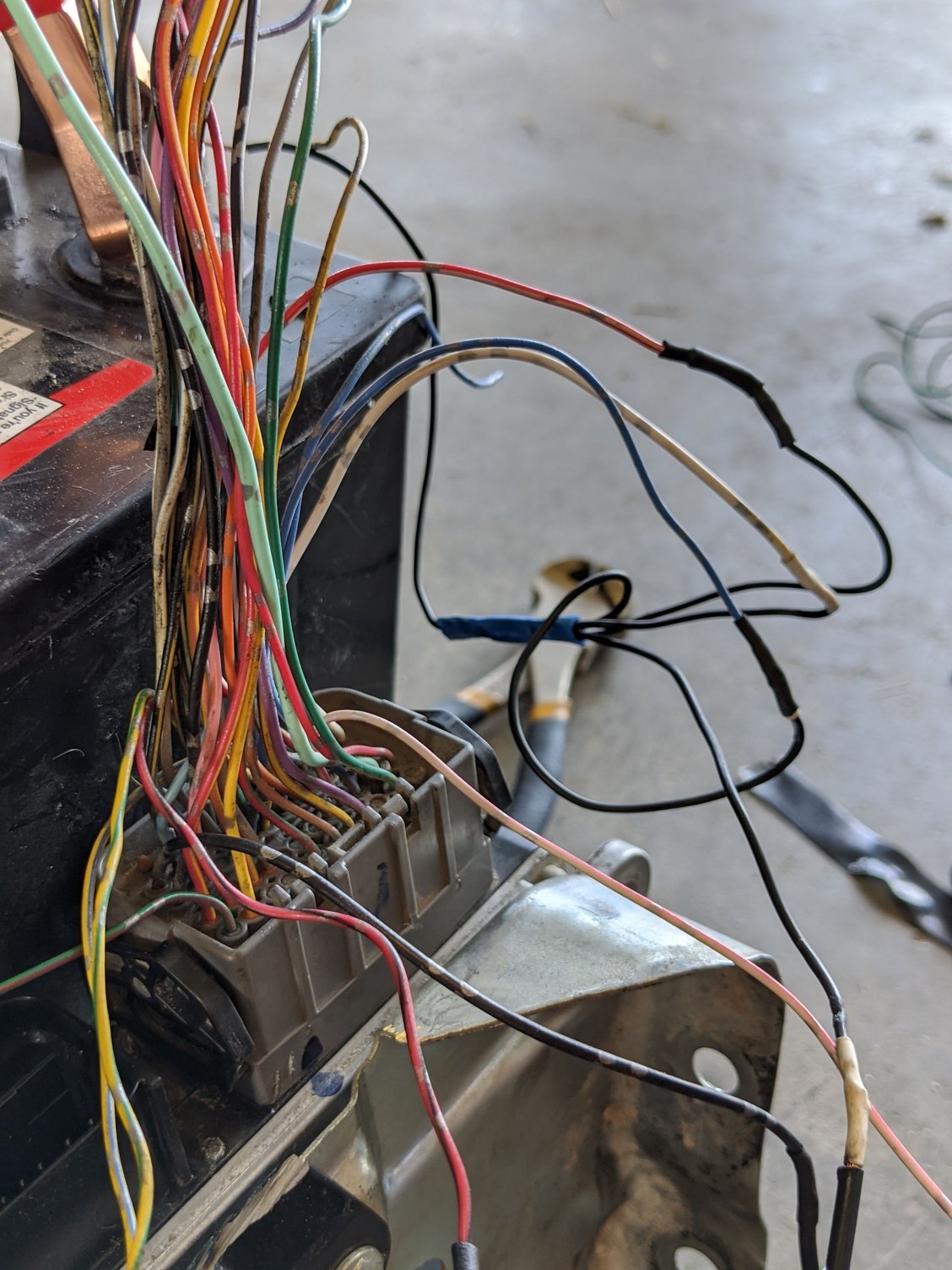

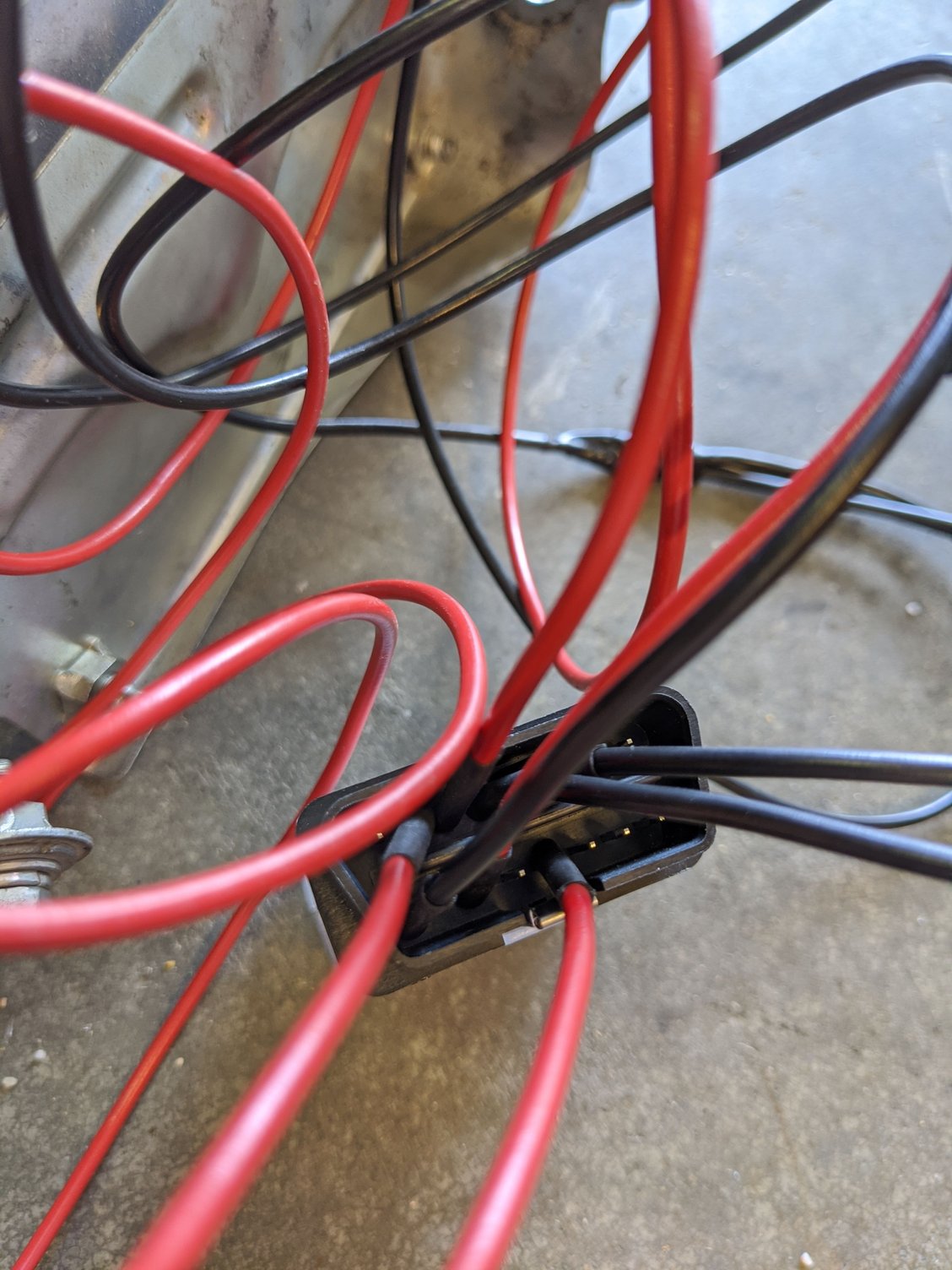

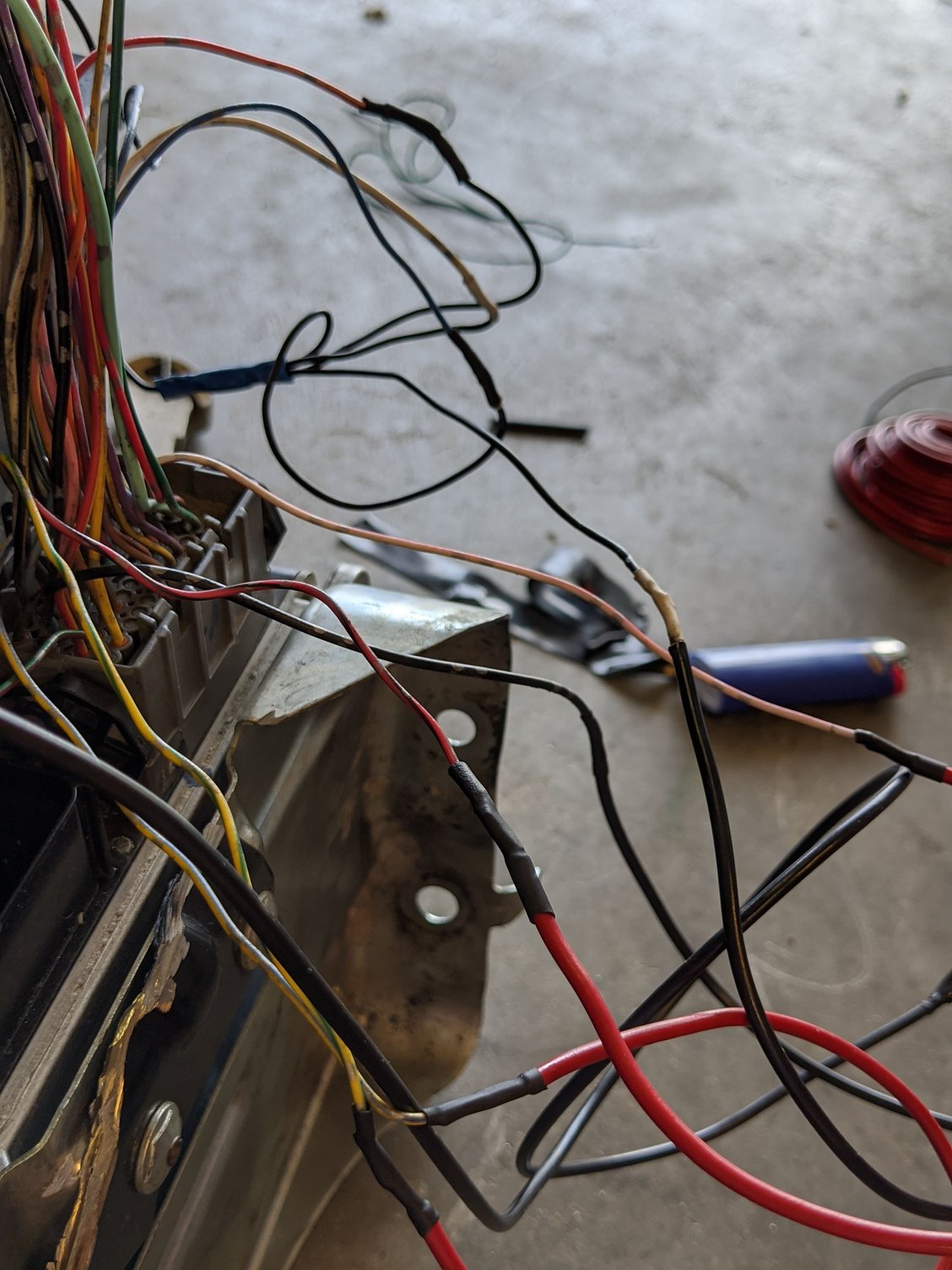

Old Aug 8, 2020 | 02:24 PM
Cole Crouter's Avatar
Joined: Oct 2019
Posts: 106
From: Saskatchewan, Canada
Alright. I took your idea for using an old harness, and I've wired everything up. However, I can't seem to get the tactrix cable to light up anymore. I made sure it's actually still working by plugging it into the car by itself, and it still works.
I've used black cables for both 12v and ground, and red for cables that go from the ECU to the adapter.
Here's what I have. I'm not sure if you can check yours, but I have 12v going to red-white-silver, white-silver, blue-white-silver. Ground goes to black-silver. Between the ECU, red-black-silver, yellow-blue-silver, yellow-green-silver, red-white-silver.
I've checked power and ground on the tactrix adapter, but I haven't made 100% sure every cable on the harness-thing is making contact properly, but it should be all fine.
I'm assuming all the cables come out of the same hole they go in. With that, I spliced each corresponding wire.
Am I missing anything?
Edit: the voltage on the battery is slowly draining, so I would assume that something is plugged in properly. Maybe the ECU?
Edit 2: I can measure 12v from various pins on both the adapter and the ECU (L side). Maybe that means there's only a problem with the connection between the ECU and adapter, and not power?
Edit 3: apparently my huge super-splice from earlier this afternoon disconnected itself at some point. That was my issuse with the adapter not lighting up. Will post back.
Old Aug 8, 2020 | 03:50 PM
Joined: Oct 2019
Posts: 106
Success! I don't know what I was doing wrong before 😅
Using the old harness was a genius idea. I lost hours last week trying to careful insert wires onto pins. As I speak, it's running right now. Fingers crossed this solves my problem.
