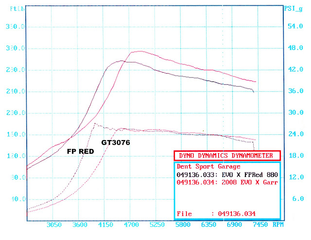

Actually, it makes better power than the Red for the same boost level. You can ask the guys are RRE, Dent Sport Garage, or the Stoptech time attack team.
From RRE with the 3076: AEM intake, cosworth cams, test pipe, AMS downpipe, ported stock manifold. low power is 91 octane, high power is E85
Palmerblock made 500whp with the GT35 version with stock cams on E85 I think. There's a thread on it around here.

I'll have to ask for a link on that dyno, bc i flat don't believe that is an evo x bolt on stock frame gt3076. a 3076 cannot flow enough air to hit 500whp, it's a 55lb turbo, the red is 60lb. Reds can hit 500 in e85 too, but 500whp at28psi on a stock frame? Not on an evo x
Hiboost has a well documented build, with every possible bolt on Inc ex manifold, intake manifold, etc and he made 380 on a mustang. 500 is not possible, period. This turbo has nothing on a black

at same boost level, it may well be more efficient. However, the reds are well known that want higher boost to come alive. And since in either case you'll want a built block, then run the higher boost - and boom you get more power from a red.
Hiboost making 425 is nice. I make 450 w/o intake manifold, or exhause manifold. I do have cams, but i'm also running 26psi!
A black has higher top end 100% than a 3076r. The compressor wheel is 35r series rather than 30r. How is that hard to fathom?

Eh? Who said anything about comparing a 3076 with a black? I was comparing it to a Red per your quote, "even in 76r form it makes less power than a red".
In having spoken to those that have used both the Red and the GT3076, they all prefer the 3076 because it has better transient response and better power, particularly when octane limited.
As for Hiboost, he does not have cams, but I don't think he'd make any more power with them as he seems to have maxed out the compressor wheel. Who knows, maybe a set of cams would still gain him something.
As for the Stoptech time attack car using the ATP GT35, I want to say it made 550whp on 109 octane, and 600whp with meth. Through a catalytic convertor due to the Redline Time Attack street class rules.
Anyways, the point I was making was to counter your statement that the Red made more power than the 3076.
