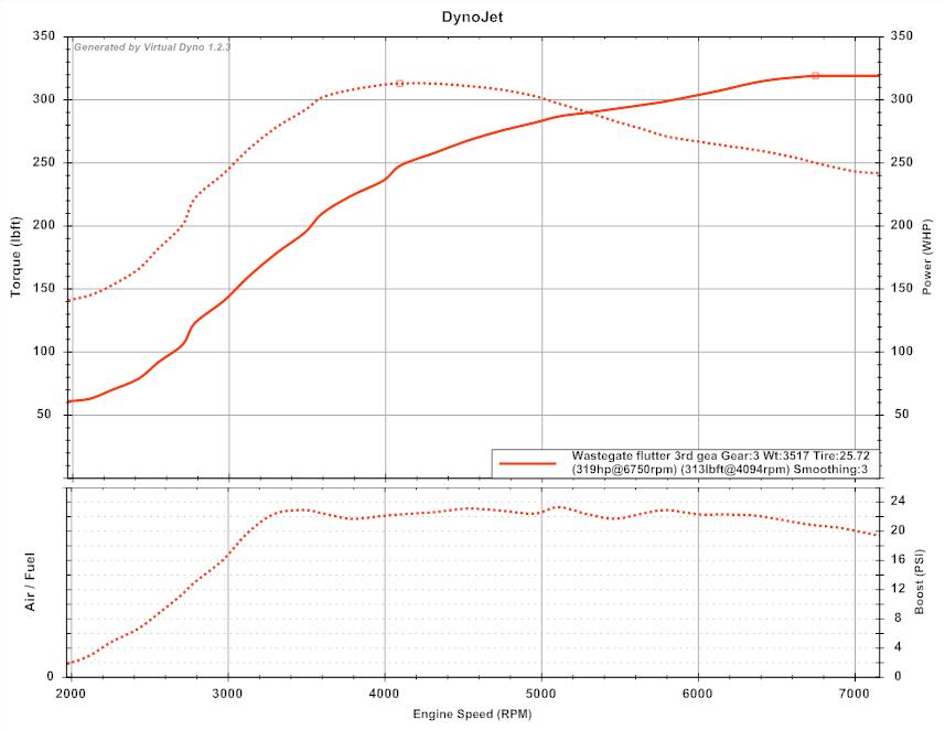

Hello everyone!
After installing a MAP UICP and grimmspeed 3-port, I noticed that when under load there is a fluttering sound. The fluttering spool occurs in 3rd and 4th gear, and above 3k rpms. The fluttering occurs when 50% throttle is applied. The spool sounds normal in the beginning, but after ~16psi is when the fluttering occurs. The sound only occurs when I am on the throttle.
The fluttering doesn't seem to be affecting performance. There is no compression surge, and my max boost is around 23-24psi.
I thought it was the UICP leaking. I re-tightened everything, but the fluttering is still there. I have done some research, and it seem like wastegate fluttering is commonly heard with 3-ports.

I have attached a log and virtual dyno results.
I just wanted to make sure that what I am hearing is normal, and the wastegate fluttering doesn't harm my turbo or engine? I do not mind the sound, but it just sounds really...intense haha.

Your boost curve looks aiiight, nothing terrible or catastrophic.. Just by glancing your VD plot.. Probably just need to adjust the WGDC % tables, aka you're going to need a tune for the best results. The OTS tunes doesn't react well to a mix / match of parts, as I'm sure you know. Regardless if the parts are "similar" in design, they may perform completely different.
I wish I could see your log file.. I could of helped more. Be sure the knock is within reasonable levels. If there's a lot of knock activity, turn the boost down.

If you hear it at the top of the pull thats the turbo running out of puff I'm on HKS panel, GS 3port, upper hard pipe, 3in single catback, and tune at 23psi 337HP/349TQ and I get the same sound kinda like fuf fuf fuf fuf while on wot at the end of the rev range. If it was surg you would be getting a different sound plus large vibrations from the engine bay this is caused by makeing more boost then the engine can handle which mostly happens with bigger turbo's or running a lot of boost. Looks like the next upgrade should be the turbo any thing else at this point won't make much gains with the stocker maxing out.

It's the way an EBCS works. If you had an open dump for the wastegate, you would very clearly hear it open and close as the wastegate cycled during spool up.
