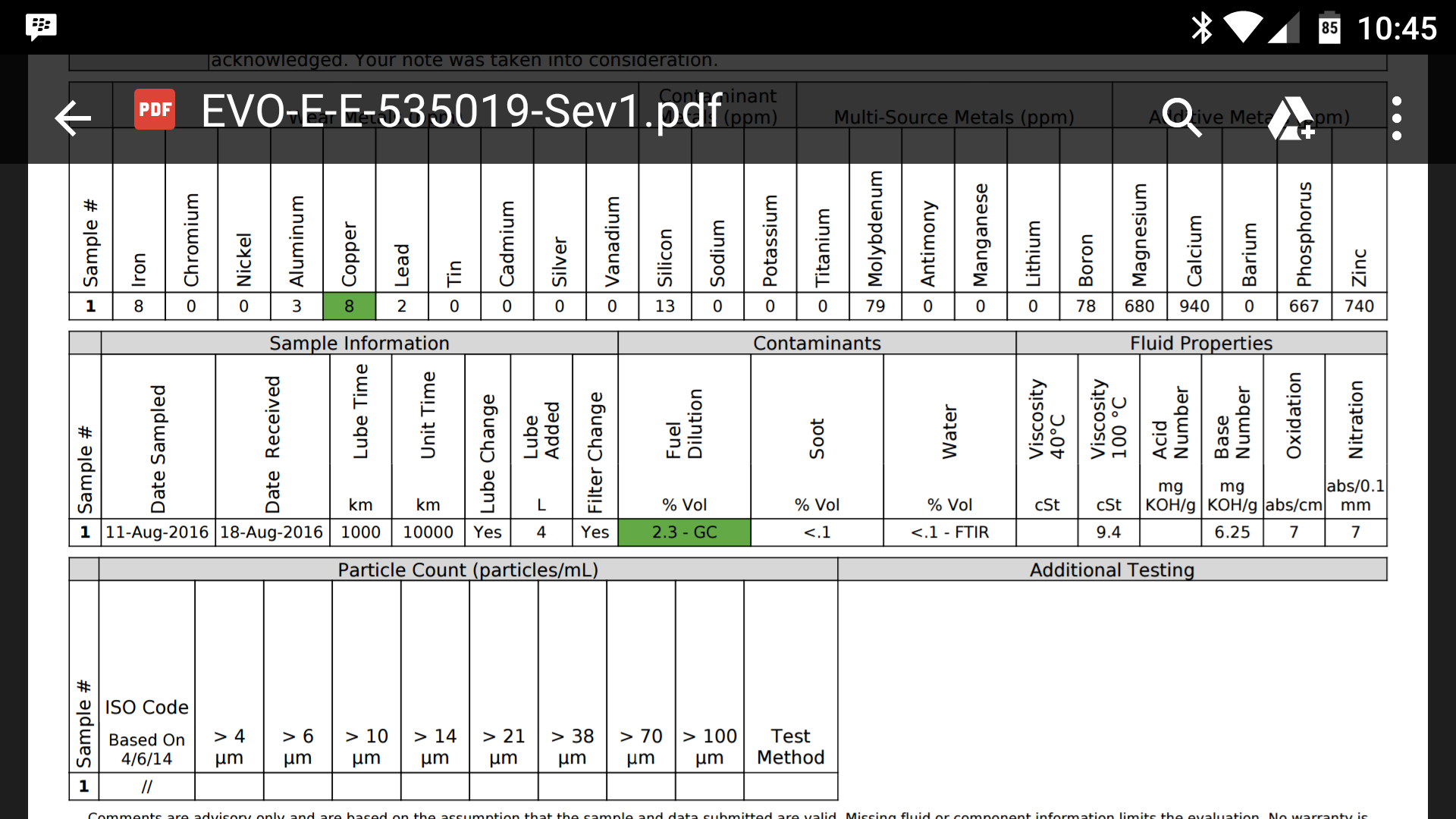

So oil analysis came back what's everyone think..
