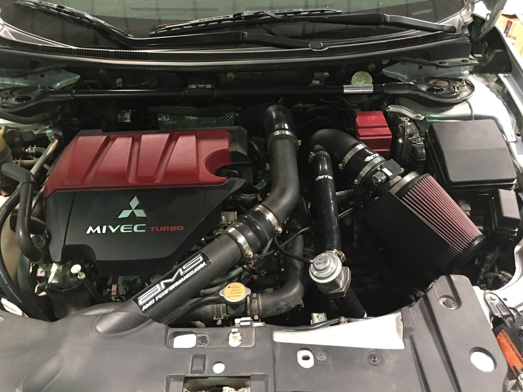

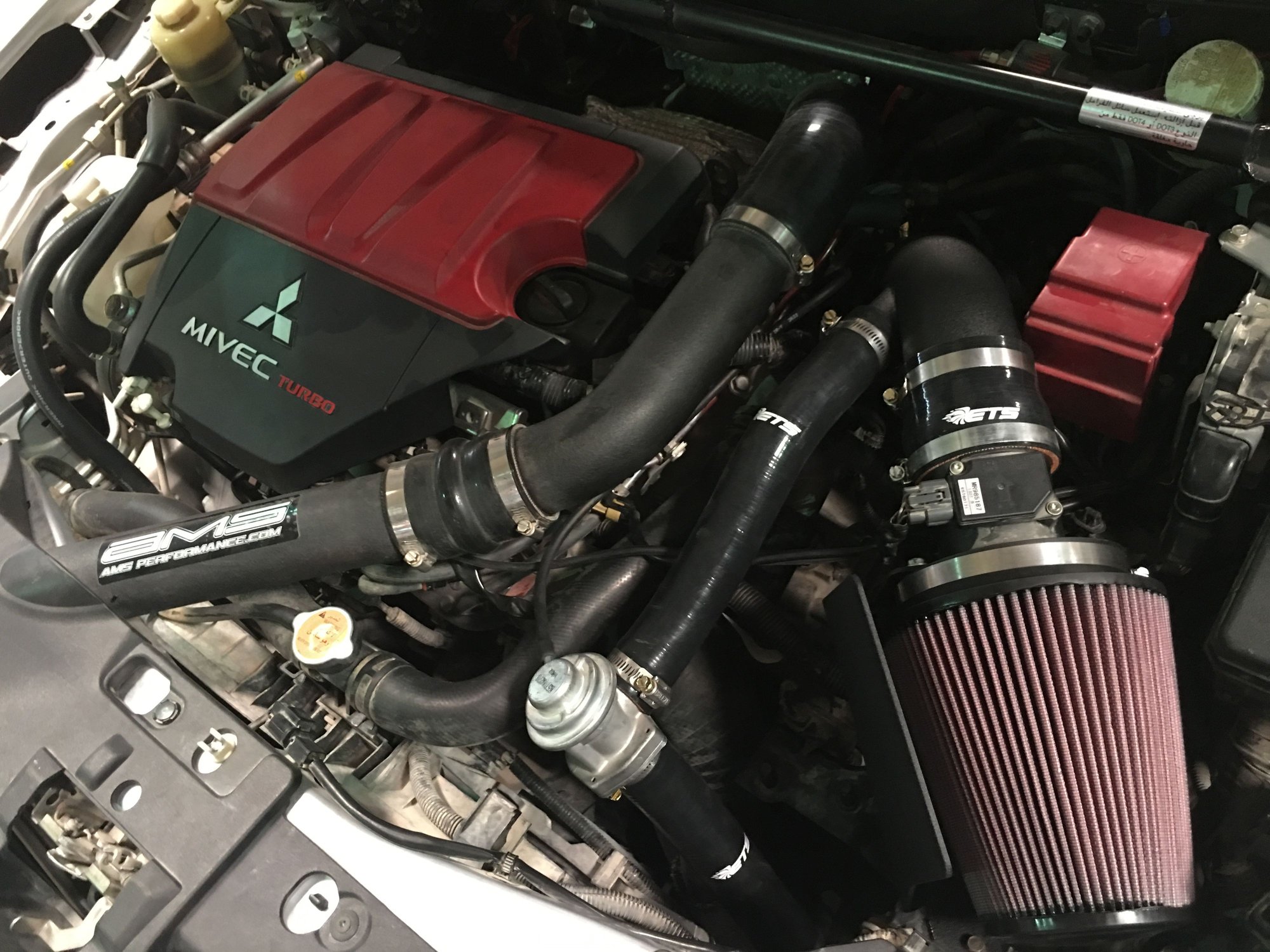

ETS intake was installed today, needs some fine tuning as im going lean above 5500RPM, but in general spool up is better by 400-600RPM compared to stick airbox with drop in K&N filter.
Im not matching your spool up numbers but it could because of the heat and elevation. I was testing in 105F and elevation of 2300ft. I see 20psi at 3900RPM and 26psi at 4300RPM.
Once final tune is updated i will take it to a dyno.
Adding some pictures from today
