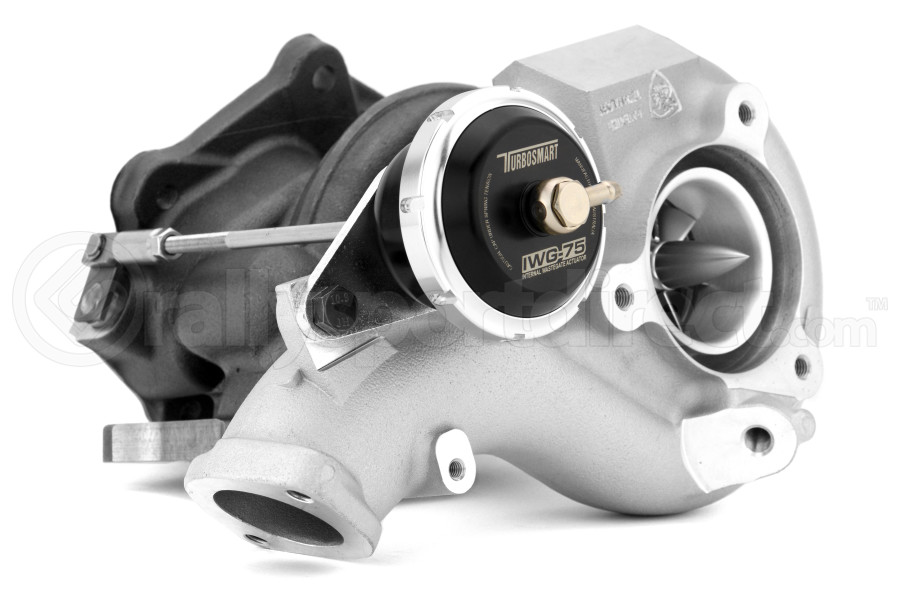

Hey guys, figured I'd document my build here. 08' Evo X GSR with factory long block. Car has been babied by one of my good friends who bought it brand new.
Long story short, the stock turbo is toast. Instead of finding a stocker, I came across a killer deal through RallySport Direct on their last Cavalli Stage 1 BB turbo for far less than I would've paid for an MHI 18k. It's described as "540HP Rating
53mm inducer/ 56mm exducer" but I know some have seen some mixed results with it, claims to flow somewhere around 56 lbs/min. I thought I'd document my findings in this thread about what kind of power it makes and how reliable it is. Chet Rickerman is doing the tuning and we will be using E85. Here's to hoping there will be enough fuel to hit 450whp!

Those turbos are junk. they make sh*tty power and have terrible spool. you would've been better off buying a turbo that is designed by FP and manufactured by MHI (the MHI 18k).

Not to mention Cavalli doesn't use OEM turbine housings. Their turbine housings are the chinese counterparts. they will eventually suffer from a warped wastegate flapper. it is not a matter of if it will happen, but when it will happen.

Junk turbo. Had some locals try them, I tuned them all of them. All spooled horribly for the power output, really bad wheel matching, and one had the compressor wheel fail on two units until he had enough and switched to a GTX3076R. Another had the exhaust housing crack because they are cheap metal.
There is a reason you don't hear much about them and they cost what they do.
Perhaps you will have better luck but I wouldn't expect much.

That compressor nut is silly enough to make me not buy it.
