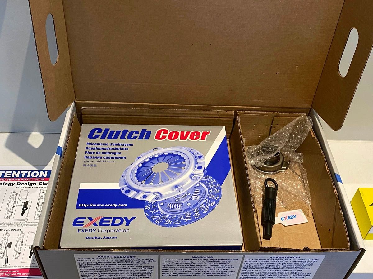

The Exedy OEM clutch kit includes:
1a) A pressure plate
1b) A clutch friction disc
1c) A clutch alignment tool - This specialty tool is essential for aligning the plate and disc properly. If your clutch kit does not include this, ACT makes one (p/n: AT03).
1d) A clutch release/throw out bearing - This is essential and is included. Nevertheless, if your clutch kit doesn't, you can buy an OEM one (p/n: 2317A001) or an Exedy one (p/n: MBAK101).
1e) high-melting-point spline grease - My Exedy clutch kit includes a sachet of this grease as courtesy. If your clutch kit does not have this included, the Honda OEM Super Hi-Temp Urea Grease (Honda p/n: 08798-9002) is perhaps a suitable alternative. See Exedy's Technical Note 051 under the appendices below, for how not to apply this excessively.

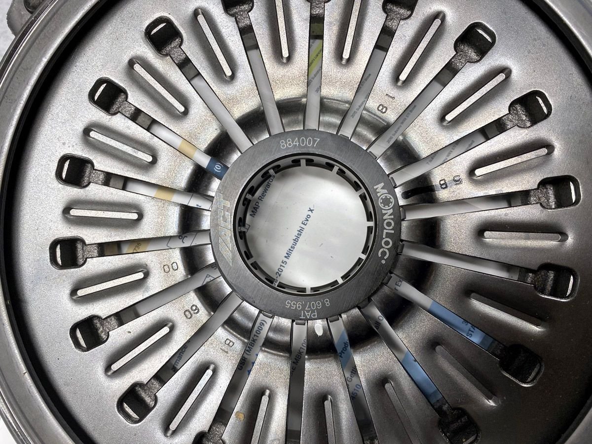

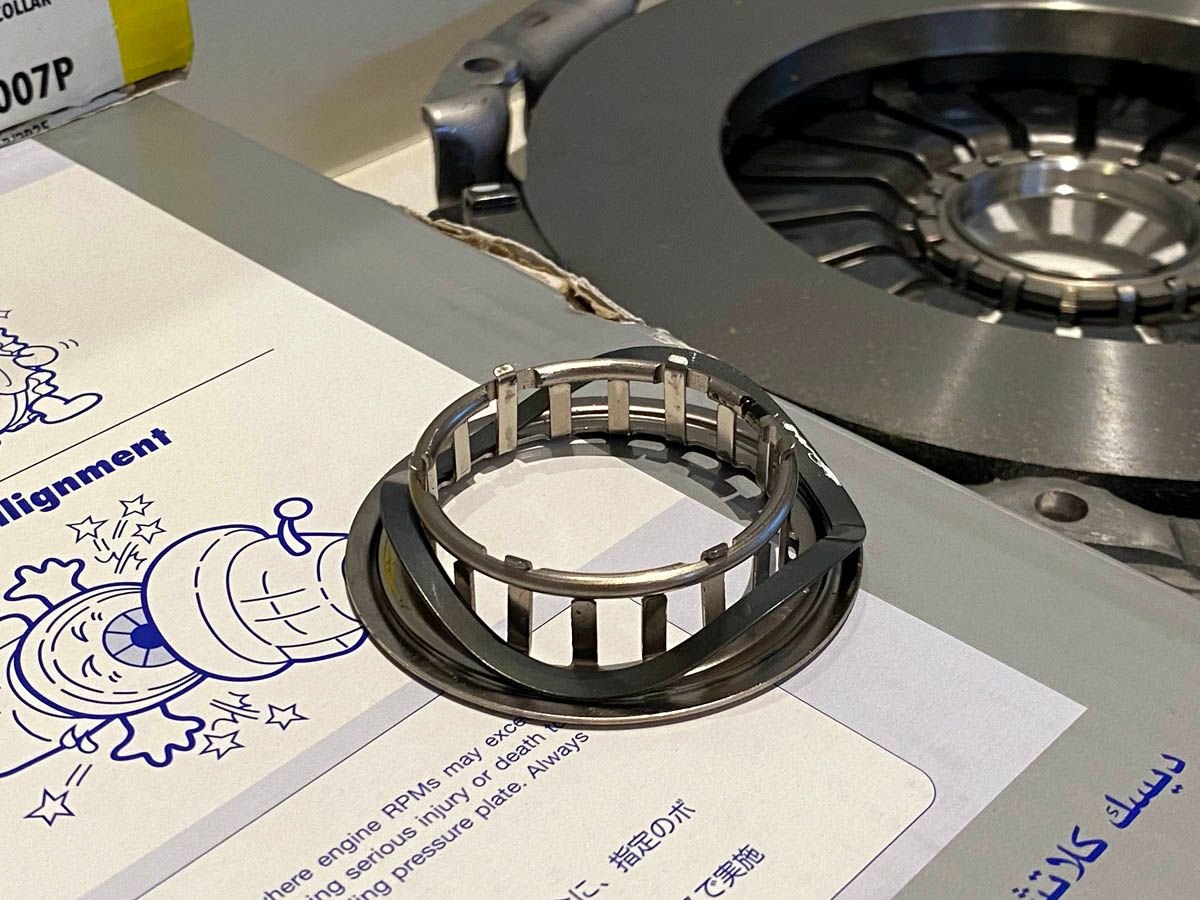

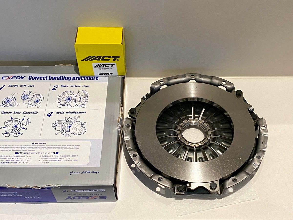

3. ACT Monoloc collar (p/n: 884007P)
The Evo X pressure plate typically comes with a 2-piece collar, which could sometimes disintegrate and cause the clutch to fail. The one-piece ACT Monoloc collar prevents this (ACT-branded clutches usually include a Monoloc, and you don't need to buy separately):
Originally Posted by AWD96
We have a local guy who is on an Exedy Triple, he literally popped his clip 3 times in a row like it was nothing. He got the Mono-Loc when it was first released from STM, and has not had one issue since. I know that during install, if you don't get the trans into the clutch just right, you can damage the fingers on the clip, I think thats where alot of peoples issues are coming from
According to STM:

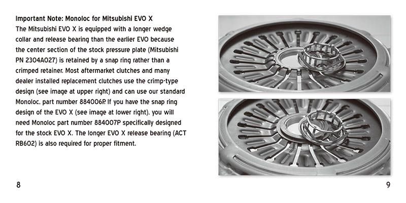

  • Evo 9, 8, 7, and 2004-2021 Subaru STi with a pull-type clutch (i.e. crimped retainer) should use ACT Monoloc collar 884006P.
  • Evo X with an OEM or OEM-like push-type clutch (i.e. snap ring type retainer) should use ACT Monoloc collar 884007P.
According to ACT:
Originally Posted by AdvancedClutchTechnology
The 884006P is designed for use with pressure plates that use the wedge collar held in by a crimped retainer for pull-type applications such as Mazda RX-7, Mitsubishi EVI VIII / IX, Subaru WRX and Sti.
The 884007P is for use with the original style Mitsubishi EVO X pressure plate that uses a wedge collar retained by a snap ring. [...]
Originally Posted by ACTman
[...] The snap ring portion of the collar (both stock and Monoloc) is the only part that determines the location of the bearing into the lever plate (center of the pressure plate).
If the collar was too tall or short it simply wouldn't snap in place. If it snaps in place, then is will work. [...]
While ACT clutch kits usually included a Monoloc collar (proper for the pressure plate type) as courtesy, my Exedy OEM clutch kit (p/n: MBK1009) comes only with a 2-piece collar (which is usable, but the installer must be careful not to damage the fingers of the 2-piece collar). Because the Exedy kit's pressure plate is the OEM push-type, I also purchased a 884007P like Xtra_Slo (the YouTuber) and Brandon Foust (an MAP customer) did.
Although the Exedy kit's pressure plate features a no-corners-cut metal ring (almost looks like those pull-type clutches'), I asked my shop to install the 884007P regardless. Afterwards, I have been driving my Evo X with MBK1009 and the 884007P for a week. Thank the Machine God, there has been no problems. I am not sure if a 884006P could even fit the Exedy MBK1009 kit.
^ Page 8 and 9 of ACT Monolocs installation instruction.
^ Page 8 and 9 of ACT Monoloc's installation instruction.
To avoid confusion, you can have the ACT Monoloc collar, appropriate for your pressure plate, installed before giving it to your shop. Also, ACT recommends using both the wave springs included in the 884007P. The wave springs might help with uniform loading and smoother initial engagement:

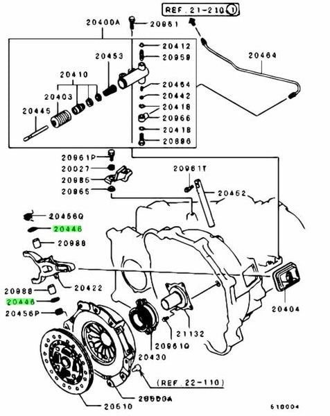

4. 2× Mitsubishi OEM clutch fork seals (p/n: MD749474)
As the best practice, these two seals should be replaced every time. They prevent engine bay oil and grease from leaking into the clutch.
^ MD
^ MD749474 (part #20446 in the diagram).

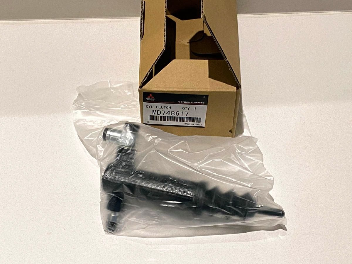

7 (optional). Mitsubishi OEM clutch slave cylinder (p/n: MD748617)
A Mitsubishi OEM clutch slave cylinder often lasts 50k~100k miles, depending on vehicle usage and pressure plate weight. If your clutch slave cylinder is old, replace it with a new OEM one during this service.
Unlike the OEM clutch master cylinder which is plastic, the OEM slave cylinder is metal and plenty durable. I do not believe that you need a stronger aftermarket replacement.

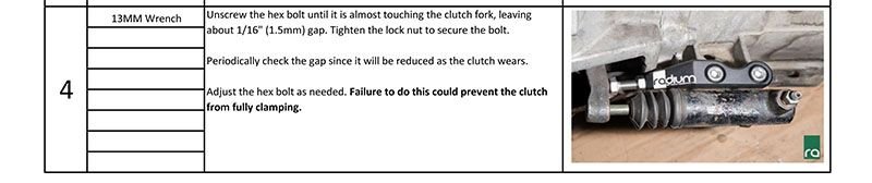

§   Not needed: Radium, STM, or MAP clutch fork stop
While salespeople may recommend a clutch fork stop, it is not needed with an ACT Monoloc collar in place. They prevent the same problem. However, the ACT Monoloc collar is maintenance-free, while the clutch fork stop requires periodic gap adjustment:
^ Step 4 of installation instruction.
^ Step 4 of Radium Engineering Clutch Fork Stop installation instructions.
Originally Posted by htotheinzel
You only need it on a multi disc clutch setup like an exedy twin or triple
It goes over the slave cylinder and prevents the throw out bearing from becoming unclipped during hard shifting
Originally Posted by Babs
This is why I completely removed mine...I had an STM one too and it just kept backing out so I just decided I didn't need to slam gears anymore for the car's sake and the clutch's.

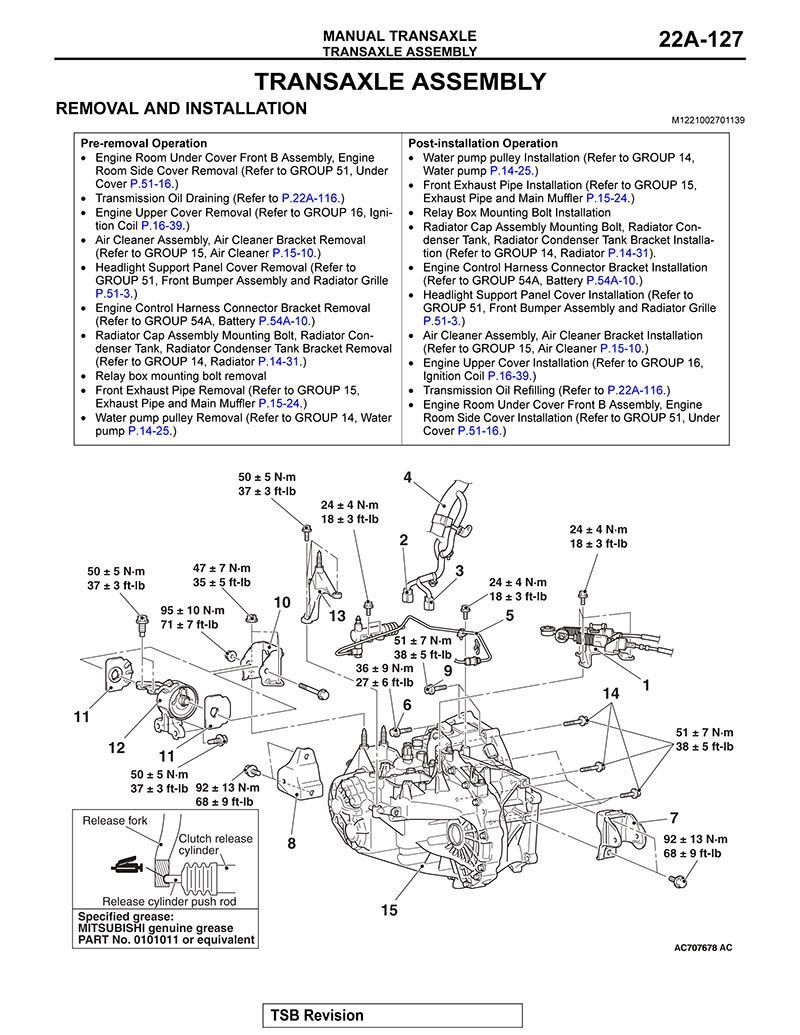

^ Service Manual Group 22A - Manual Transaxle
^ Service Manual Group 22A (Manual Transaxle) page 22A-127. This page specifies that Mitsubishi genuine grease (p/n: 0101011) should be applied to the tips of the clutch release fork.

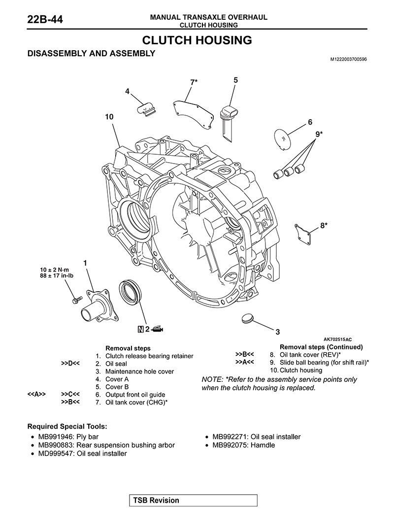

^ Service Manual Group 22B - Manual Transaxle Overhaul
^ Service Manual Group 22B (Manual Transaxle Overhaul) page 22B-44.

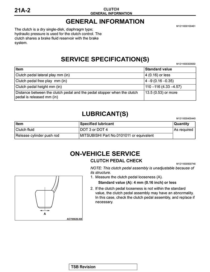

^ Service Manual Group 21A (Clutch) page 21A-2.

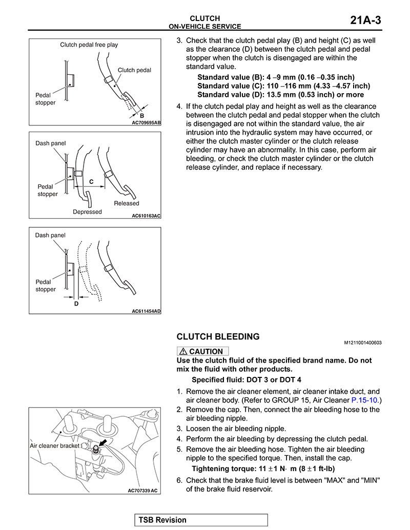

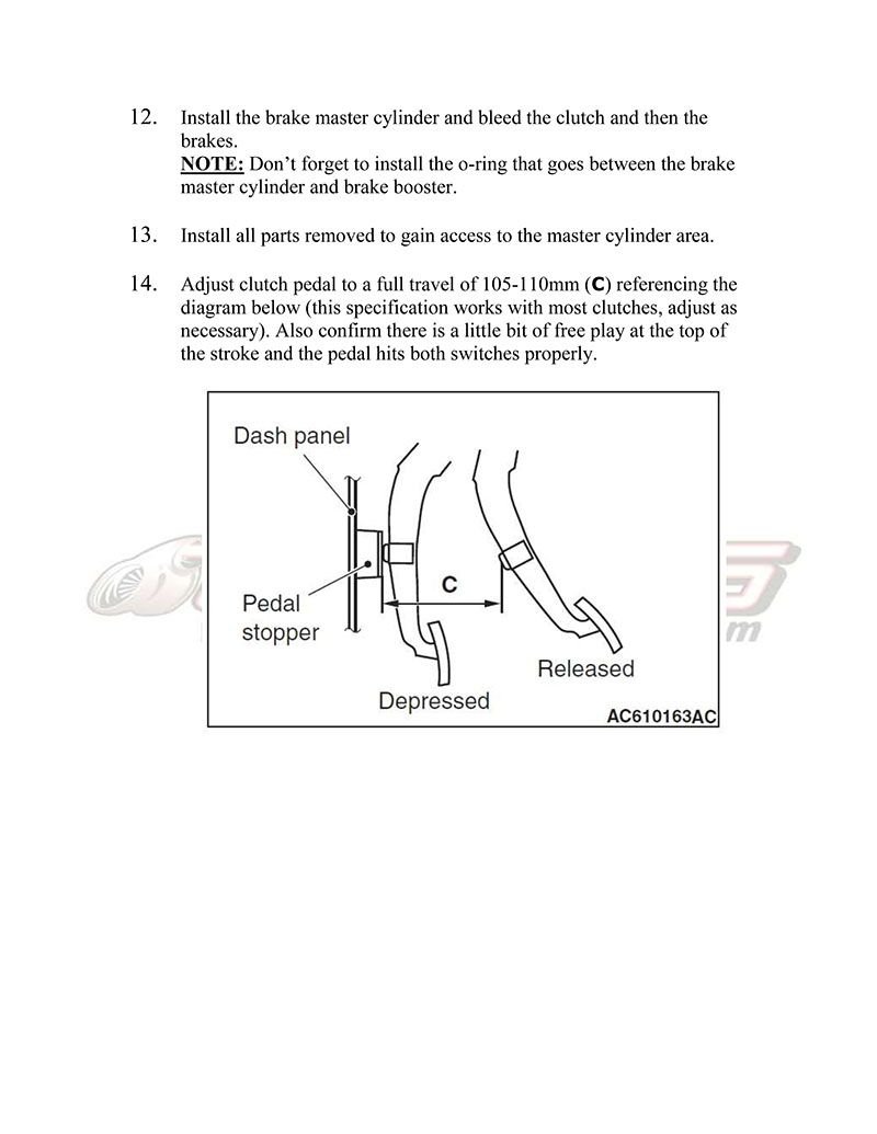

^ Service Manual Group 21A (Clutch) page 21A-3. This explains the proper clutch pedal setting. Lucky for me, my
^ Service Manual Group 21A (Clutch) page 21A-3. This page explains the proper clutch pedal setting (B value = [4mm, 9mm]. C value = [110mm, 116mm]. D value ≥ 13.5mm). Lucky for me, my clutch pedal's B, C, and D values all feel great after the new clutch is in, and thus the pedal doesn't need any adjustments.
^ Last page of the AMS clutch master cylinder installation instruction. This page explains the proper clutch pedal travel setting for the Evo X.
^ Last page of the AMS clutch master cylinder installation instruction. This page explains the AMS-recommended clutch pedal travel setting for the Evo X (C value = [105mm, 110mm])

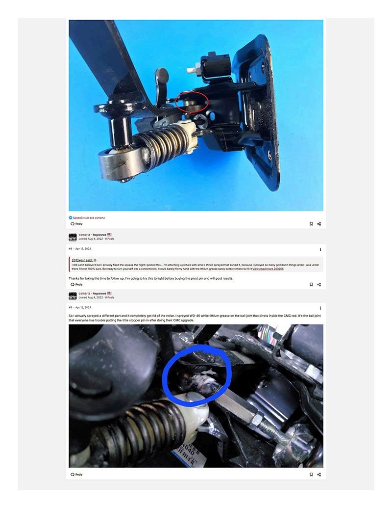

^ Clutch pedal still
^ Clutch pedal still making noise after a new clutch? This forum post circled the joints of the clutch pedal assembly that need lithium grease sprayed for quiet operations.

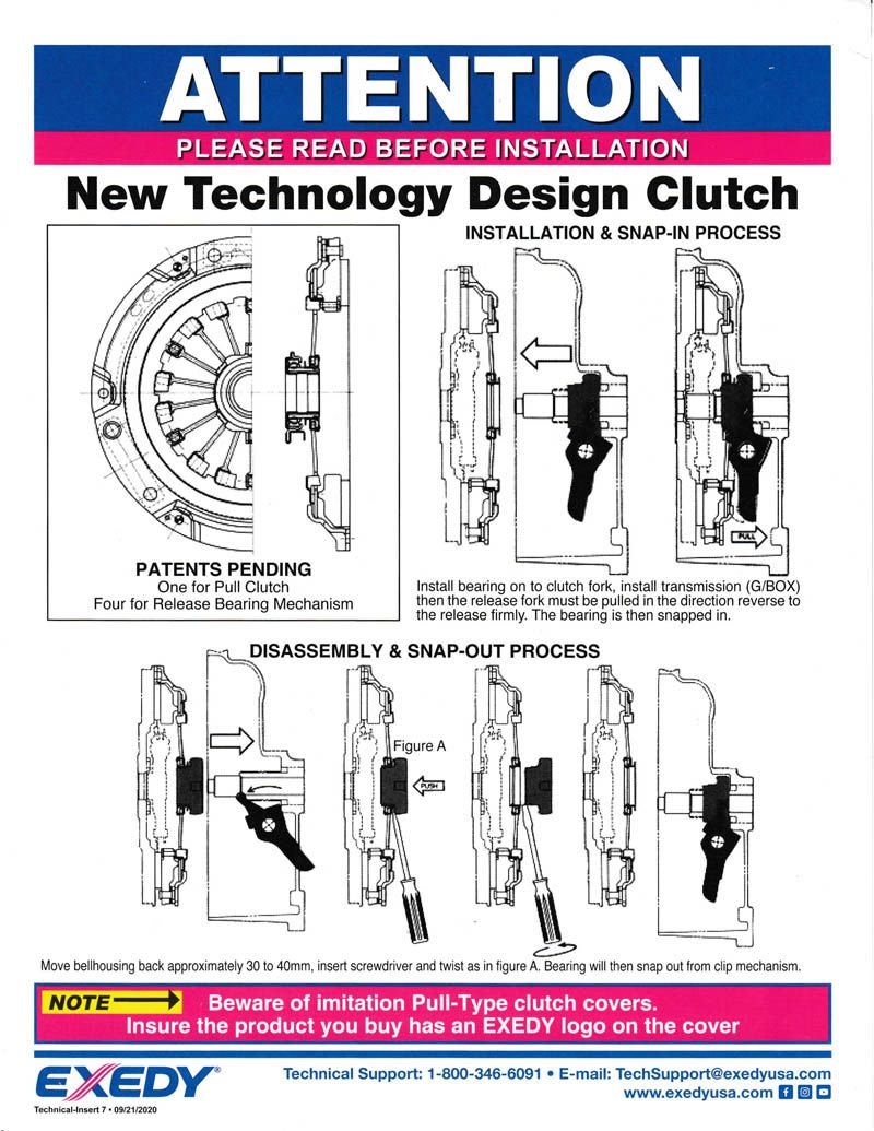

^ Exedy included 3 pages of fitting instructions in the box. This is page 1.
^ Exedy included 3 pages of fitting instructions in the box. This is page 2.
^ Exedy included 3 pages of fitting instructions in the box. This is page 3.

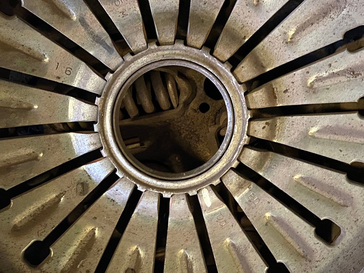

^ Pressure plate of my Mitsubishi dealer-installed clutch, after 80k miles.
^ Pressure plate of my Mitsubishi dealer-installed clutch, after approx 81k miles (130,254 km).
^ Pressure plate of the Exedy OEM clutch kit, with Monoloc collar
^ Pressure plate from the Exedy MBK1009 kit, brand new. I have an ACT Monoloc collar (884007P) installed, which replaces the Exedy 2-piece collar.

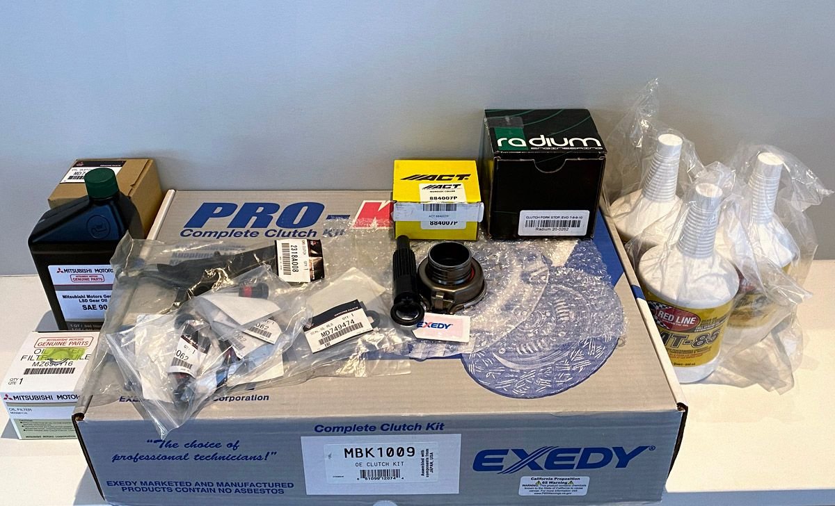

^ All of the parts
^ Parts that I provided to my shop, except the clutch fork stop (the green-black Radium box upper right) which turns out to cause more problems that it solves. On the left, the OEM oil filter (and a drain plug washer taped to it) is just for oil change.

^ Exedy OEM clutch kit
^ Exedy OEM clutch kit (MBK1009). The included Exedy release/throw out bearing, spline grease, and alignment tool are very handy. The one-page Exedy Tech Note 051 is not included in this kit, so it might be a good idea that you print the page and include it in the box.

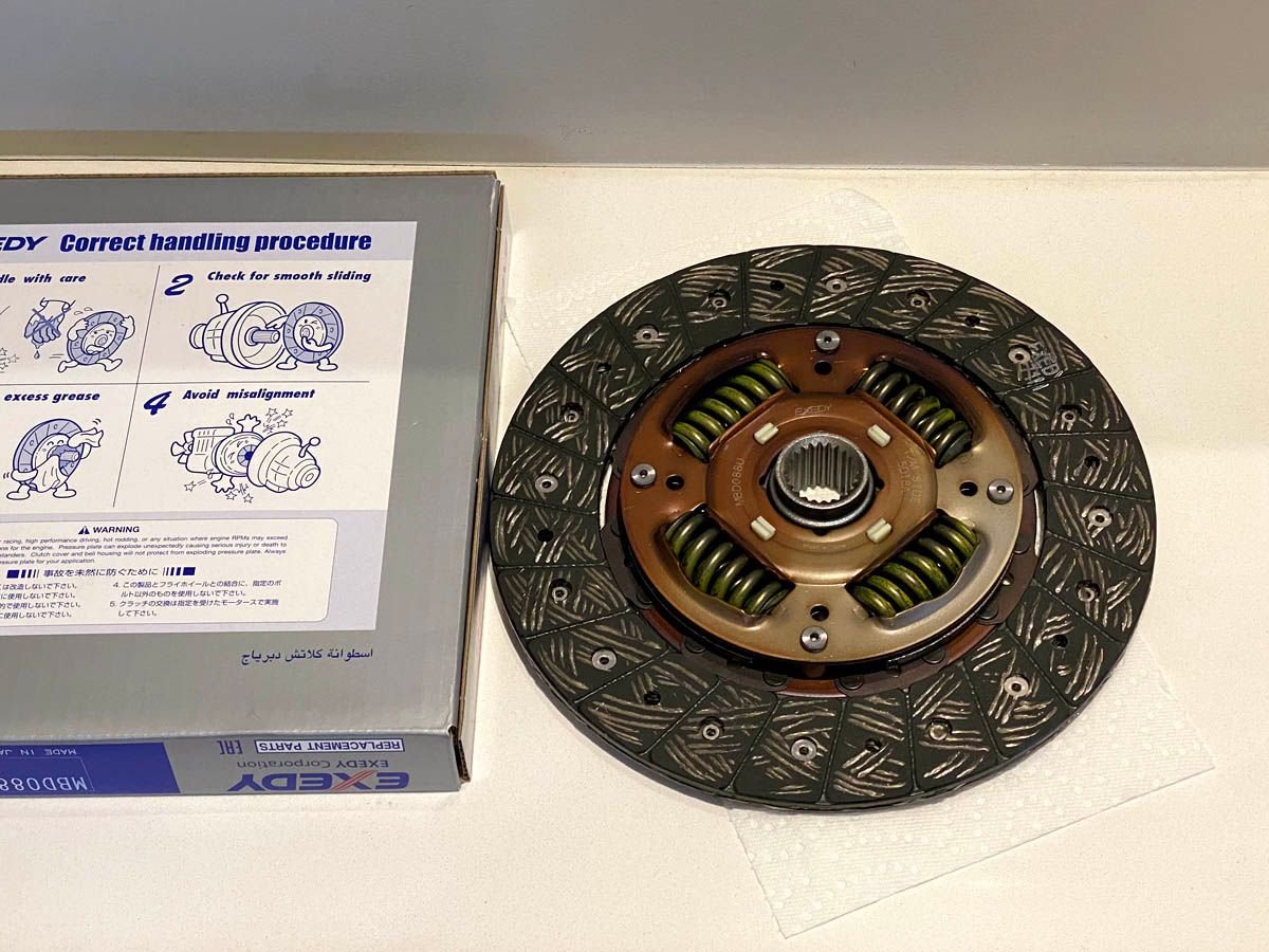

^ Exedy
^ Exedy friction disc included in the clutch kit (MBK1009). The springs make daily driving so much easier.

^ Mitsubishi OEM clutch slave
^ Mitsubishi OEM clutch slave cylinder (MD748617).

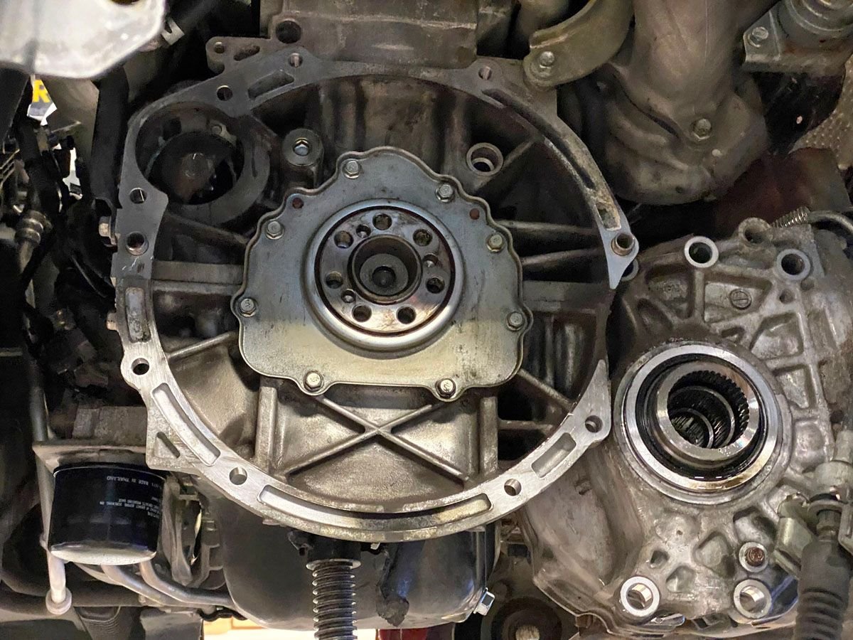

^ Transmission removed
^ 5MT transmission and flywheel removed.

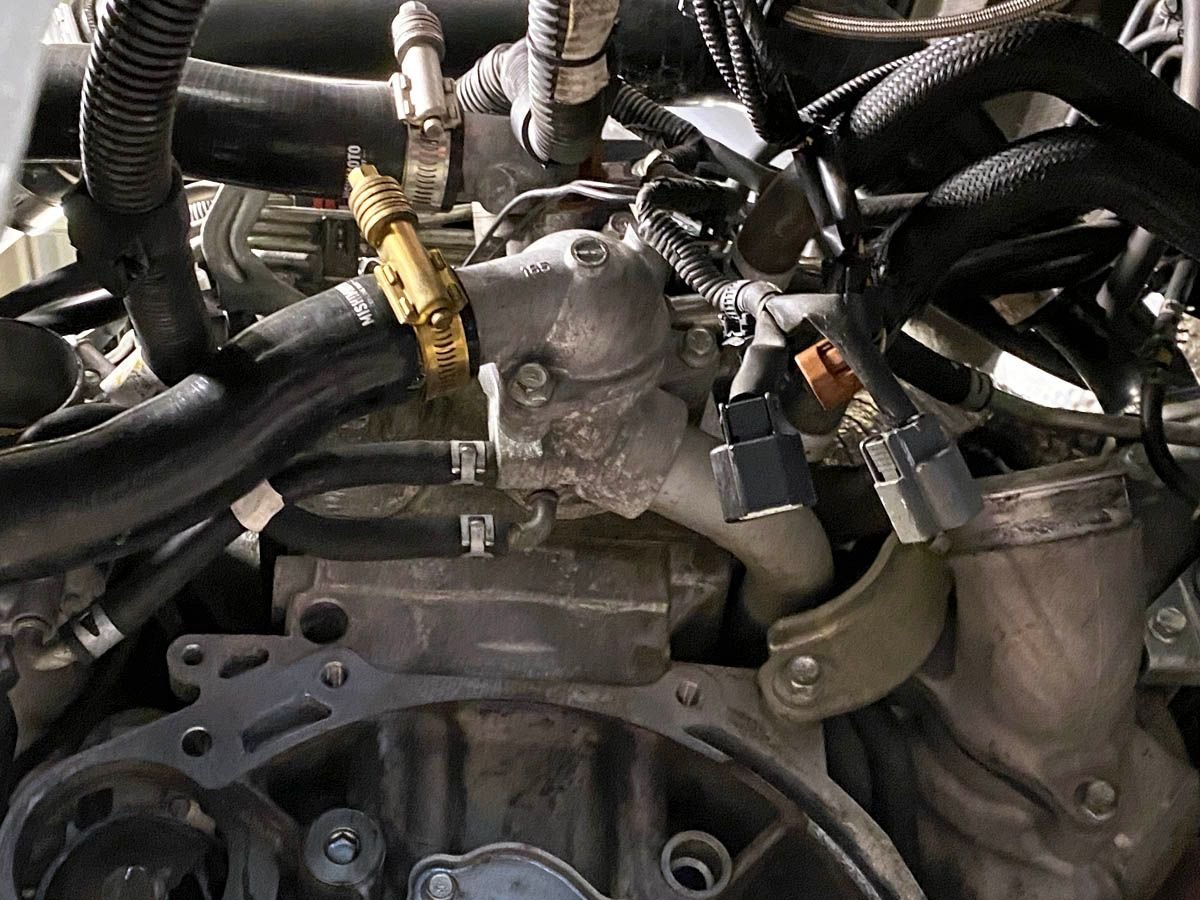

^ Turbo and coolant hoses going into the engine.
^ Turbo and coolant hoses going into the 4B11T engine.
