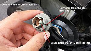

Bringing this back from the dead, hopefully with some new information.
I read about quite a few people complaining the lights keep going out, but after what I just went through I am wondering if it is faulty wiring causing the issues. I just replaced one of the DRLs today and the DLR still did not light up. I took out my multimeter to perform some testing and it appears the blue wire is not connected securely to the silver circle that the bulb fits in. Check out the picture I attached and let me know what you think. Is it possible that all we need to do is solder the raw wire to the silver circle to eliminate the DLR bulb issues? I hope I am not oversimplifying this, but if I am let me know.
