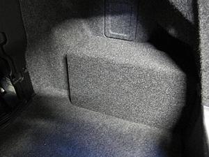

Relocation kits are ready for the 2008+ Evo X and Rallliarts...they look absolutely awesome even better than I could have expected....the boot space looks stock! I just got all the step by step pics and will post them Friday when I have a moment.
How noisy is the pump in the trunk?
Is putting the pump in the trunk going to be okay keeping it cool?
The pump only turns on briefly and you shouldn't hear anything from the trunk.
The pump doesn't need to be kept cool, in fact it makes the pump have to work harder...never heard of any problems relocating and don't perceive having any.

The finished look...
Attached Thumbnails For those of you with ACD pump failures (merged)-acd.jpg
Is this based upon knowing the actual temperature tolerances or just speculation? These pumps have failed during both mild and hot temperatures.
Not based on speculation at all. The pumps fail not because of the hot or cold temperatures, but because the pumps have been damaged by corrosion sitting underneath the car unprotected. During hot weather the fluid therefore is thinner and leaks out the damaged pump, and in cold weather the pump has to work harder to push the thicker fluid and since the pump is damaged, you get your dash lights and codes with pump failure.
