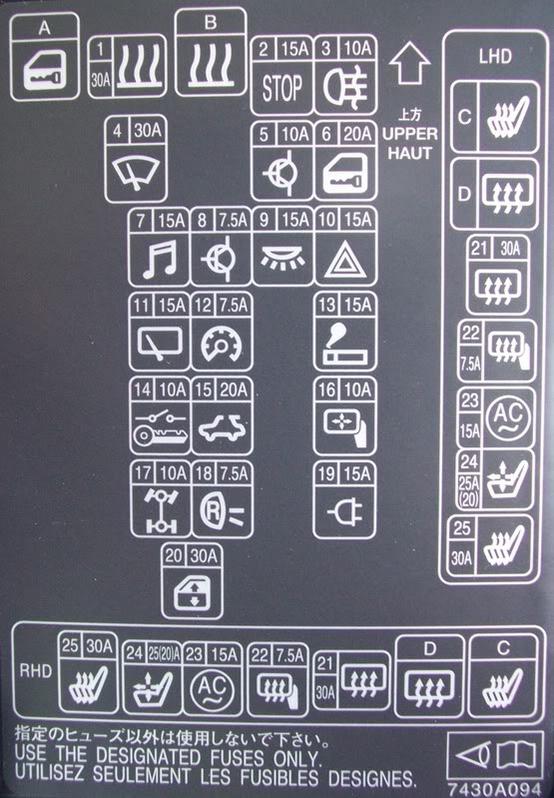

I will move it, but I'm more concerned with WOT than anything !
I looked and I'm getting Mixed signals on whether the aem requires a pure air calibration at key turn or the start up with cig lighter is sufficient. I looked the only 12v constant I have is radio that causes a weird noise in speakers(normal prob), ignition stays on, I'm not sure if headlights would work or not as a source that does not reset.
