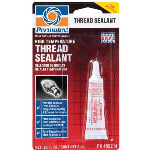

UPDATE: This thread has quite a bit of info https://www.evolutionm.net/forums/ev...e-senders.html looks like this works so long as the oil pressure sender is running off of the AMS pressure sending unit (to reduce vibration) and the bolts use Permatex and NOT teflon tape. Teflon tape will leak, can't handle the temperature and is probably not something you want floating around your oil system and gumming up your oil filter anyway.
