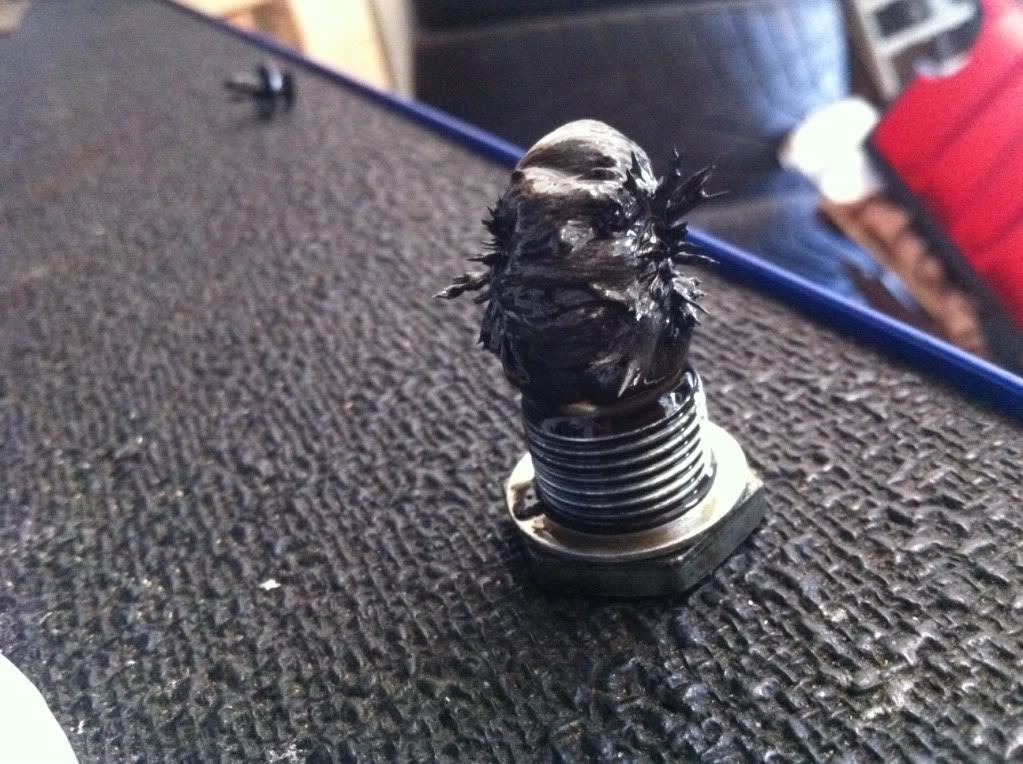

This is what I took out yesterday from the Transfer Case. The most I ever seen and I service it every 10k-15k with Dia queen LSD oil. Some other people said it has a whine sound also.

Old Oct 21, 2016 | 08:02 AM

That looks like a lot of metal for it being changed that frequently.
Old Oct 21, 2016 | 09:45 AM
LetsGetThisDone's Avatar
Joined: Oct 2013
Posts: 15,973
Likes: 1,629
Yeah. The tcase shouldn't make that much metal.
Old Oct 21, 2016 | 01:18 PM
Fuego's Avatar
Joined: Sep 2011
Posts: 635
From: El Paso
I agree. Looking to see how to really check to see if that's the issue. I know jacks repairs them but i want to know all my options at this point :-((
