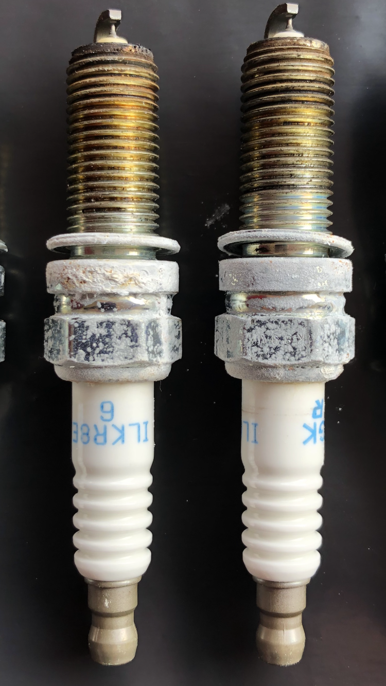

Been having some issues when it comes to accelerating recently. It’s almost like it’s hesitating to build power. From what I’ve been able to find, people with similar issues seem to come to the conclusion that it is fuel related. Checked the fuel pump relay and it is the “old” black one. Already ordered a replacement and decided to take a look at the spark plugs. Found that two of them have white chalky residue on the bodies. I’ve only been able to get mixed opinions on what it may be from. Possibly oil? Any ideas/thoughts are appreciated.

Is that salt spray getting into the spark plug tubes?

That is 100% from moisture in the spark plug tubes.

Check for signs of moisture in the tubes and on the coil packs. The tube is sealed by the coilpack.

The residue on the spark just looks like spark plug anti-seize lubricant
