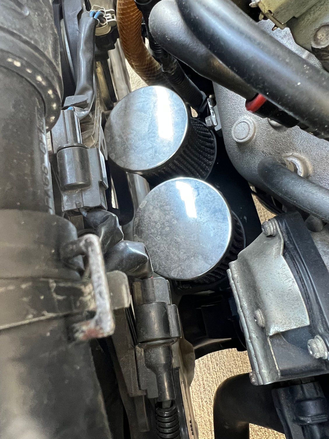

Originally Posted by RobbieOh
That does look like a catch can hose.
Yeah im guessing that hose is just routed into the box where the intake is.
Old Oct 15, 2022 | 06:58 PM
BryanSorto10's Avatar
Joined: Oct 2022
Posts: 10
From: VA
sorry all late I been busy but this is where the clear hose is going in too
Old Oct 15, 2022 | 07:01 PM
Joined: Oct 2022
Posts: 10
From: VA
I’m new to this whole car thing so I have no clue what that is
Old Oct 15, 2022 | 07:34 PM
Robbie called it. Vented catch can!
Old Oct 17, 2022 | 01:56 PM
bcollins92's Avatar
Joined: Aug 2016
Posts: 39
Likes: 9
From: Michigan
So the smell you are getting is normal for a vent to atmosphere catch can like you have. Put the hvac on recirculate and you should be good to go, make sure you drain it every few tanks of fuel
Old Oct 17, 2022 | 03:31 PM
ViciousLSD's Avatar
Joined: Oct 2011
Posts: 3,858
Likes: 600
From: Houston
I wouldnt call it "normal" if PCV isnt working. you can vent-to-atmosphere and still port crankcase blowby to pcv/intake, so it doesnt stink when idling or cruising
Old Oct 18, 2022 | 01:31 PM
bcollins92's Avatar
Joined: Aug 2016
Posts: 39
Likes: 9
From: Michigan
For the set up he has it is completely normal to smell the smells he is getting. From the looks of it, the pcv is still on there and he just has the drivers side breather port routed to the catch can. I would personally run both lines from the engines breather ports to that catch can and block off the port on the intake manifold.
Old Oct 18, 2022 | 01:58 PM
ViciousLSD's Avatar
Joined: Oct 2011
Posts: 3,858
Likes: 600
From: Houston
I have 2 large port breathers but I dont smell crankcase gases while idling, cruising or racing. my pcv still works. its abnormal i guess
Old Oct 19, 2022 | 10:34 AM
bcollins92's Avatar
Joined: Aug 2016
Posts: 39
Likes: 9
From: Michigan
Wild, I don't have a pcv and have the same catch can as the OP and get the same smell on both of my cars with the catch cans. Which is to be expected when your're collecting a liter of blow by gases in a can with breather ports on top with constant air coming out of the engine crank case and into the catch can. Ours must be broken
Old Oct 19, 2022 | 12:10 PM
ViciousLSD's Avatar
Joined: Oct 2011
Posts: 3,858
Likes: 600
From: Houston
yeah welders everywhere are in a race to sell catch cans and stuff. we can see there are buyers who would be ok sniffing fumes. SAE certified techs so give them your money
Old Oct 20, 2022 | 01:53 PM
Joined: Oct 2022
Posts: 10
From: VA
Hello guys I found the part, so for the late response I have a crack on the manifold. So I gotta replace or weld it.
Old Oct 20, 2022 | 02:00 PM
ViciousLSD's Avatar
Joined: Oct 2011
Posts: 3,858
Likes: 600
From: Houston
maybe an exhaust leak? or your pcv is clogged
