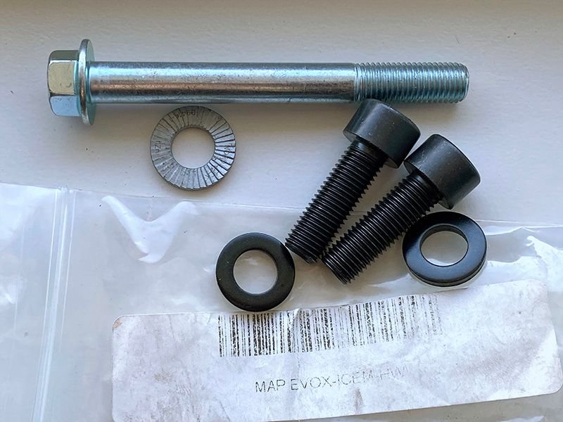

I agree. I regret buying the MAP manifold exhaust manifold; should have stayed OEM. Also, my MAP clutch master cylinder couldn't be adjusted for proper clutch pedal height, and I had to eat the loss and buy the AMS clutch master cylinder, which has been working perfectly.
^The MAP manifolds hardware.
^The MAP manifold's hardware. Unlike the Mitsubishi OEM manifold and hardware that come with 2 conical-shaped Belleville washers for each bolt, the MAP washers cannot act like coned-disc springs during thermal expansion cycles. This will eventually lead to bolt stretch and exhaust leak.
