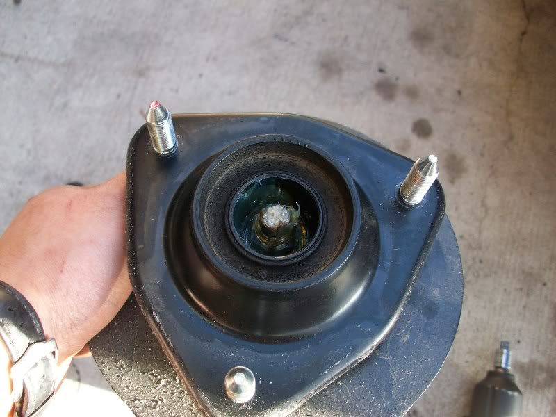

If you want this top nut to be remove and not rotate on your everywhere trying to remove it.
Leave everything bolted in the car. Use the spring compressors on the stock spring. Then loosen that middle top nut. Then take out the entire assembly.
That's an accident waiting to happen.
Do it the right way: air tools.
And I still have to re-align everything. Don't really trust anybody touching the car, so that makes it difficult. I just want it done before I get my new tires/wheels.
Some people don't have access to air tools. But do at your own risk.
