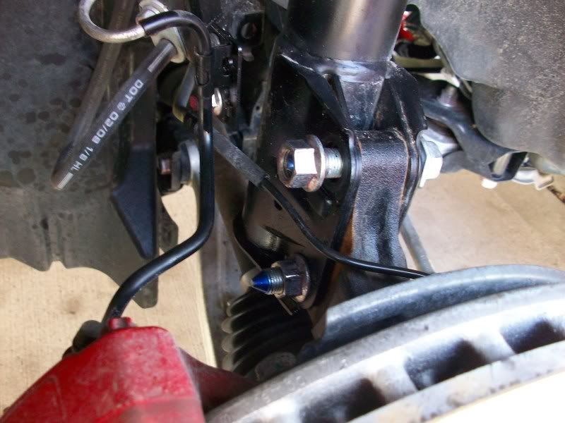

what exactly is the difference between the two bolts in this picture?
Mine had only blue on them...............
Top bolt is used to ajdust the camber. You can see that the top bolt sits on a groove so the bolt doesn't move when installed. Rotating it adjusts the camber.
