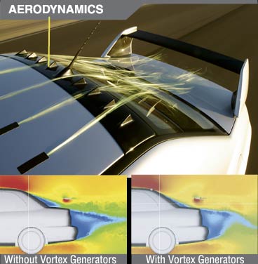

Something extra I found about vortex generators a while back. (I believe from Road and track). Just to demonstrate the flow of air with and without the VGs.
