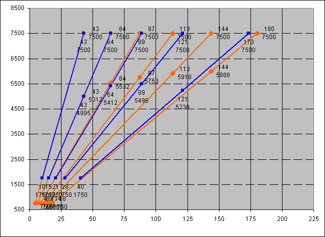

I own an MR. I would agree with most of nj1266 points. I hate the slime undercoating that Mitsu uses.
However the 6-speed I think is a good addition for road racing. The only down side I see is the slight increase in weight.
The lower 3 gears are very close to the current 5 speed. Fourth is slightly lower and the new fifth plugs the large existing gap between the 5 speeds fourth and fifth. Sixth is only a little taller than the current fifth. I would say that on many road courses the six speed may work better.
From Mister2zx3
