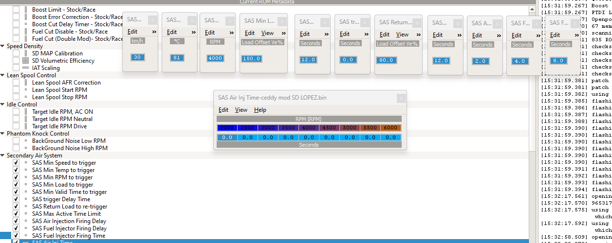

im currently using a base map with ceddy mods to start and test my engine.. i do have SAS but i havent tweak on the settings can u help me out?

I’ll do my best. Lol I’m still looking for some info but those minimum trigger settings are what is required to activate the system. So right now your engine needs to be at least at 81C, you have to be moving at least at 30kmh, and your old has to be above 150% for XX amount of time. Try setting your min load to trigger to 80 or 100, and set the minimum trigger time and valid trigger time to 1second. Also I would set your delays (fuel and air injection) to .1 seconds. That should give you some decent pops assuming you also have some negative timing and some extra fuel (think 11.5AFR) in your map. Just make sure that it’s only in the low load high rpm portions to avoid having it activate while you are cruising. There are some settings I’m not familiar with, what version of Ceddy are you running? There’s plenty of maps and other SAS setups that people have posted if you do a search. From there it may just take a little bit more tweaking to get the effect you want. Depends on if you want the big shotgun blast, burble or flames. I’m in the process of learning more about the different settings and am looking for exact answers as well but that should at least give you something to start with. Let me know how it works out!

Ok.. It looks like we on the same boat with no captin
i will try tomorrow and let you know what progress it made..
i have to check what ceddy mods version it have cause i dont really know..
