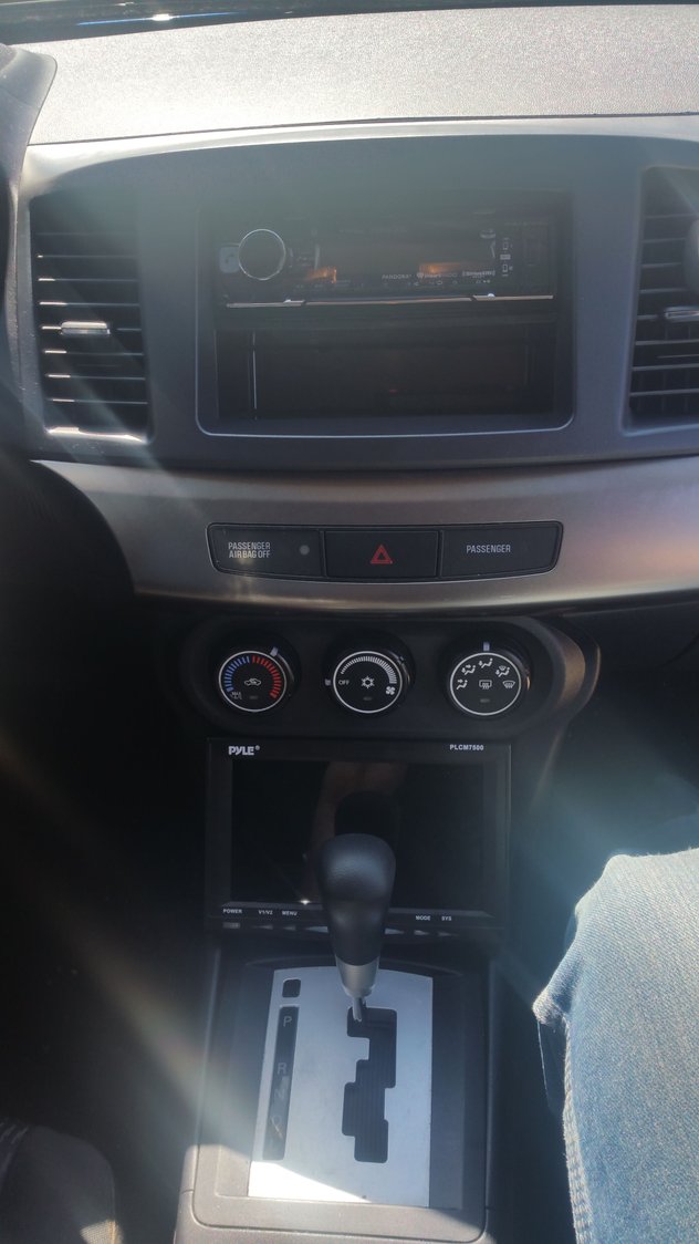

Originally Posted by yitzac1990
does the scosche kit also come with the pieces for a single DIN install? would a single DIN radio still use the factory brackets?
I Did the single DIN setup with the Scosche. definitely will be upgrading to a Double DIN overall fits good and uses stock radio bracket as well
Single DIN with Cubby
added a backup cam in as well temp moniter till i upgrade to a Double DIN
