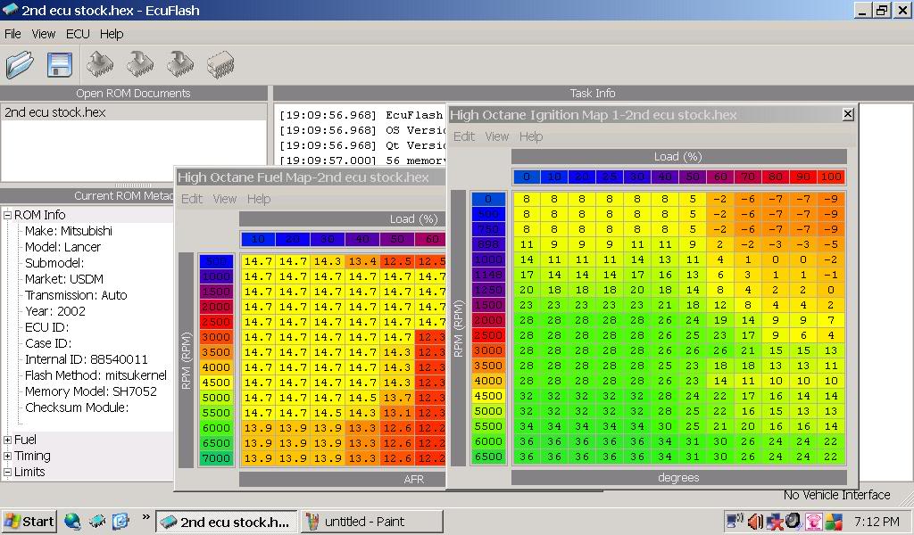

hey guys, why is my values in ecuflash (x and y) are all messed up on my desktop computer?
its all fine from my laptop and they both have exactly the same version and latest definitions.
The only thing that would change the x- and y-axis is the definition file. Is EcuFlash seeing your ROM as the same ROM ID on both your laptop and desktop?

yup it is
btw, my rom id is 88540011
yup it is
And you have the same definition file for 88540011 on each computer? And you are running the same version of EcuFlash? I don't think it'll make a difference, but are the user levels set the same in both?
yes yes and yes. i just dled ur latest definition files and latest ecuflash.
i even reinstalled ecuflash on my desktop twice, same thing..
EDIT: pics added

On your desktop make sure the endians are set correctly for RPM and load % scaling. Compare the endians between both your desktop and laptop. Having the same definition file should address this, but manually checking wouldn't hurt. I'm willing to bet that this is the issue, because if the scalings are all the same on both then I'm out of ideas.
only thing i noticed is that the one on my laptop, the data endian is set to big. (All of em) and my desktop is little (some big)
got if fixed. =)
thnx senate for the help. i just made all of the endians big
