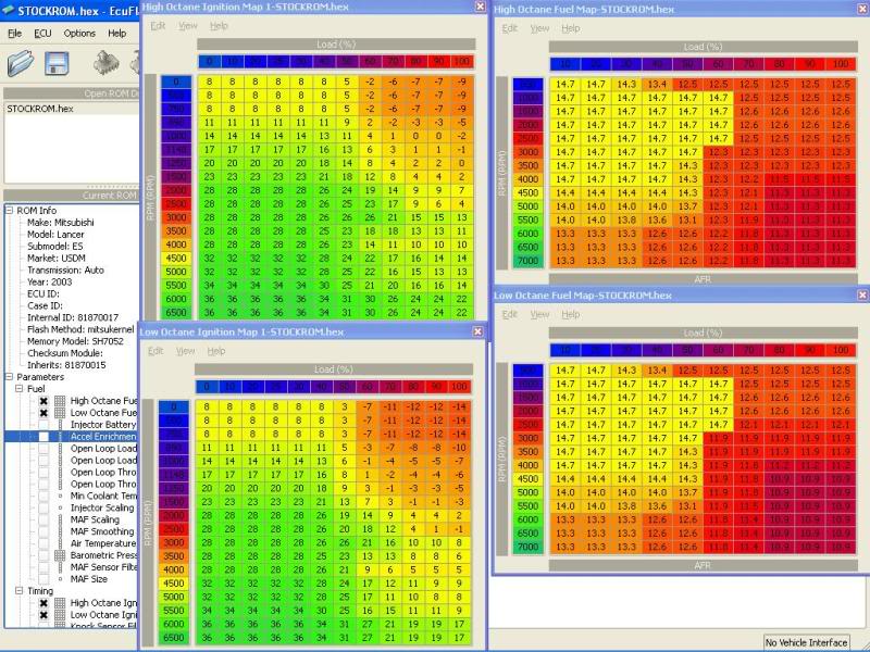

ok well i got my cable and laptop on wednesday and tried to pull my rom but when i tried to pull it a little window popped up, i cant remember what it said but it said that it couldnt find something and i had to choose the third option to open a pop down menu to choose the option for 2003 es auto then i was able to see the rom but im not sure if that was right or not i did put the def files in the right location and this is what mines supposed to be
81870015 - 2003 ES, AT
here what mine looks like and my id is 81870017
Old Aug 16, 2009 | 09:43 AM
  #140
senate6268's Avatar
iTrader: (20)
Posts: 1,987
Likes: 19
From: Buffalo Grove, IL
Everything with your ROM is right. Have fun tuning!
