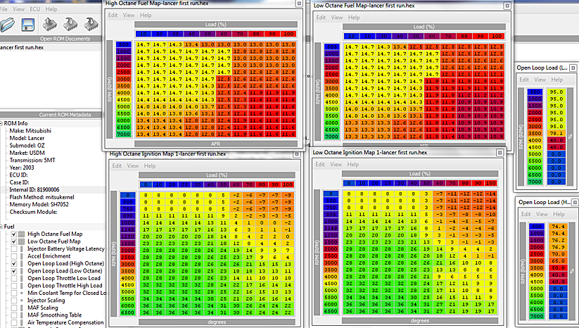

I opened your ROM in EcuFlash and was able to read every table perfectly. As long as you followed the directions on copying the master definition list in the first post you should have no problem reading your ROM. See the attachment.
