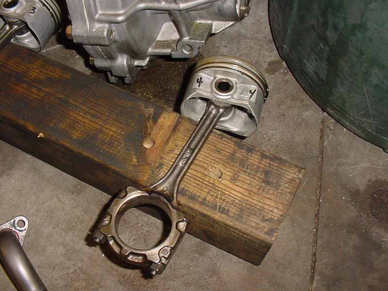

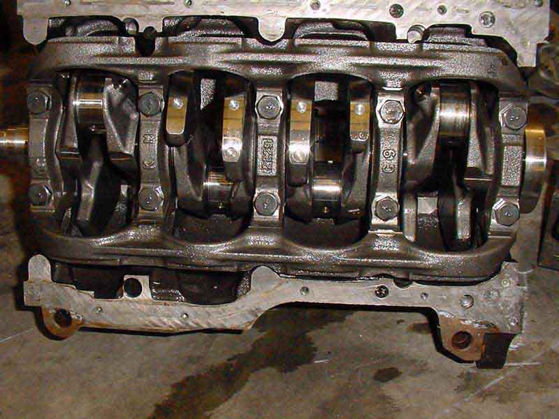

well boys and girls, just got back from my buddies shop and well the motor is torn out of the car and torn apart. If you havent heard I blew my motor, and we pulled it out to figure out what was the prob...well the pistons all look ok, but piston 4 rod bearing spun and went insane on my motor...

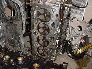

opened up the motor and the head looks fine, crank is all jacked up, from the bearing, so now i need a new crank. I am adding JE Forged pistons in just to make me feel better and I have to now replace my oil pump and oil pickup line. I am also replacing my head gasket, intake manifold gasket, and exhaust manifold gasket.
Just some fun in the sun...Hopefully all will be put back together this week or the next. Here are some pix...

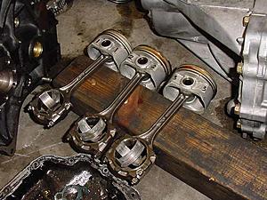

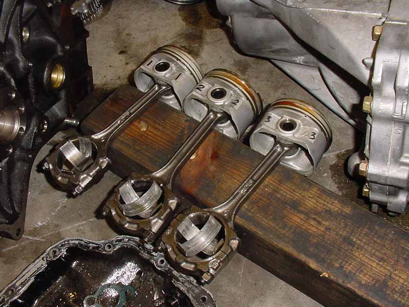

pistons...

number 4 is over here...
