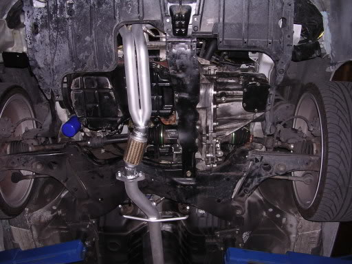

Drain all fluids and begin diconnecting all hoses/lines and wiring harness.
Unbolt ALL motor mounts and remove engine and transmission like so:

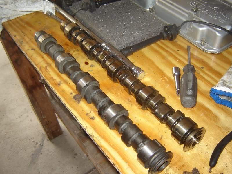

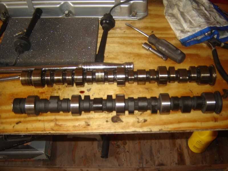

Now would be a perfect time to put on any bolt on parts that you might have for this motor (except for the intake). If you got the cam shaft this is THEE BEST time to do this. Open up your valve cover, take off the cam sprocket and the cover to the opening for the removal of the cam shaft. when completed it should look something like this:
the cam shaft at the bottom is the Crower Cam Shaft. It is a REGRIND of a stock G64 cam so if you need one, I can get you one.

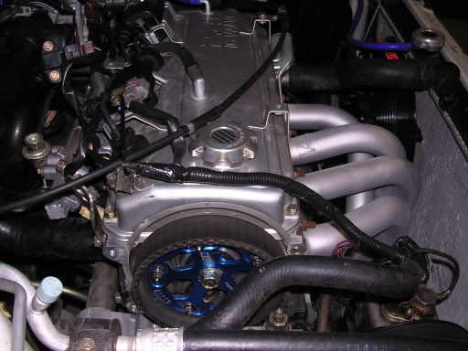

Once you are finished it should look ike this:

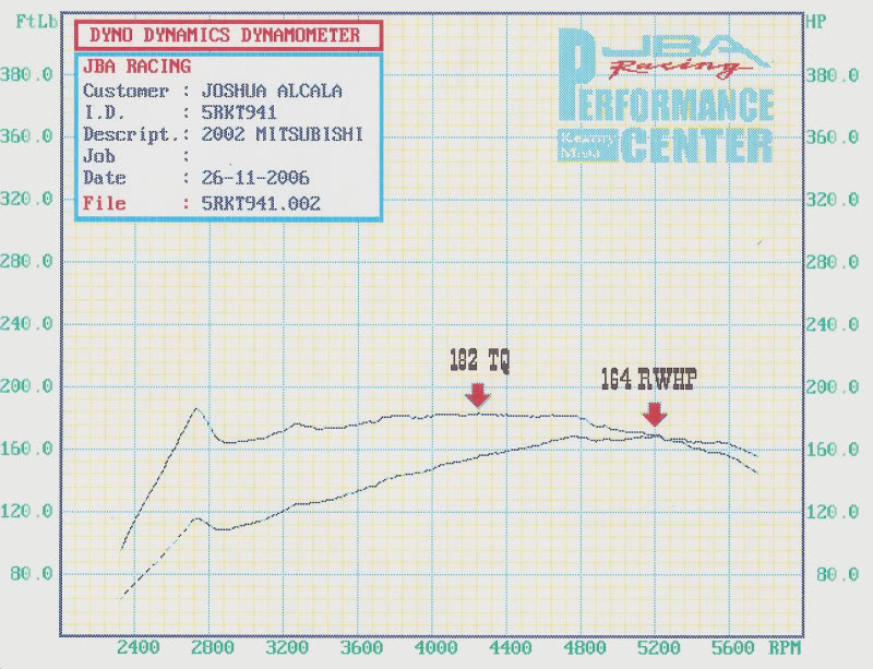

***UPDATE!!***
I FOUND MY DYNO CHART! 164 WHP 182 TQ!!
