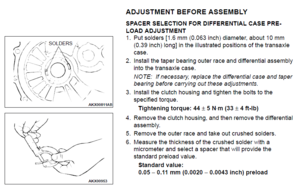

You should revise your transmission reassembly notes to include proper procedure for shimming and measuring preload settings to prevent irregular wear and damage. Here's the procedure from the FSM:
And here's a nice writeup/explanation of what shimming and preload means in a transmission and how to measure/calculate how much is needed:
http://www.twingles.com/ideck/rebuild3/dretranny5.htm
