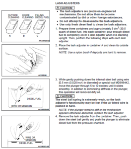

Originally Posted by senate6268
It's the lifters. Mitsubishi lifters are notorious for this across many models. As the mileage on your engine goes up they get clogged and dirty and need to be cleaned. For them to be cleaned they need to be removed from the cylinder head and soaked in diesel fuel.
Nice. I'll have to do this. Pretty simple? Any suggestions?

It's a fairly involved process. You need to semi-disassemble the head. See the FSM page below.
