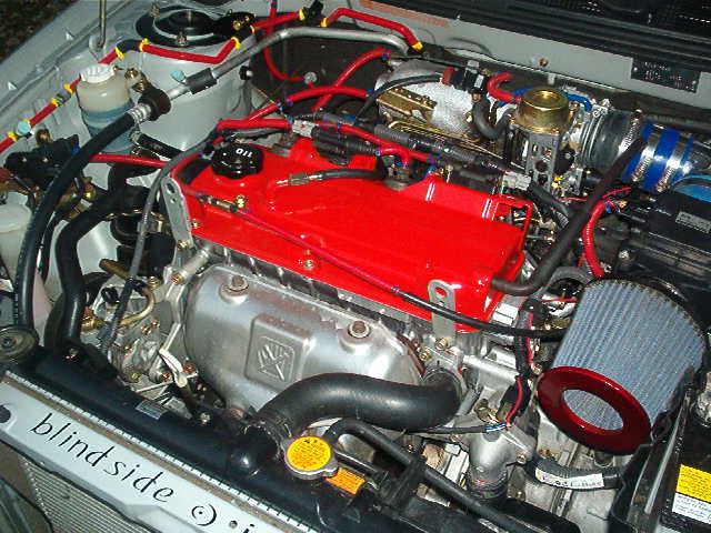

What do you mean "whats the deal". Everything will be done tomorrow. The only thing that was done to my car as far as internals is the JE pistons. Plus the head work. The JE's run the exact same compression as factory, 9:5:1, The head shaved and cleaned up will give me alittle better flow plus a little more compression. NOT much though. The engine will run exactly the same as stock, the difference is that I will be able to run more boost. But them again I wont have a turbo installed until spring. It is wicked cold in my garage.lol. The only thing that kept me from starting today is the battery. Its on the charger and I will crank it up in the morning. The only thing that I will probably have to do is, prime the valve lash. All that involves is running the engine to 3000rpm and let off, might have to do it up to 30 times is what the service manual says. So stay tuned!

It finally done- valve lash was real loud when I first started it. But after priming and driving down the road for about twenty miles it has quieted up. I'm EAR TO EAR BABY!!!

awesome work man! people get a huge pit in their stomach when they hear a blown engine, but with the right know how, it can be real simple to fix the lancer and get it on its feet, great job again man and im glad to hear your running! remember to break those JEs in good man. yo umust feel like i did when i finally got my engine rebuilt! what a joy right?

What do yo guys think of my Ford Red Enamel Valve Cover?lol
