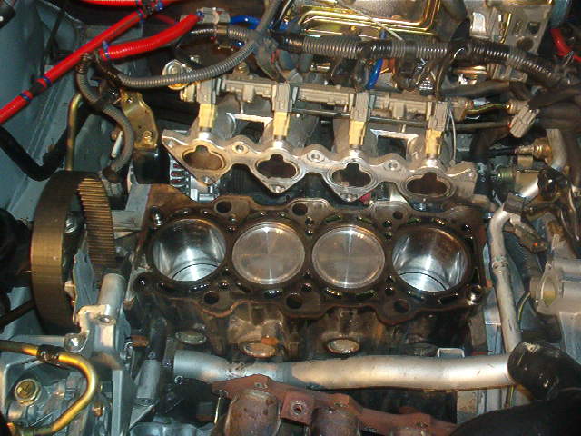

With the new JE pistons installed. We are are ready to put it all back together. We are getting excited! lol. so the block is cleaned off one more time and we are ready to set the head.

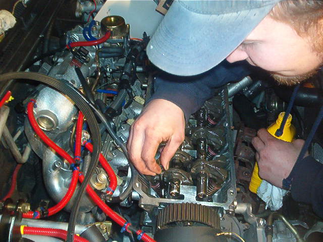

With the head on we put the rod bolts back where they came from. I inspected each bolt and they all check out. lol

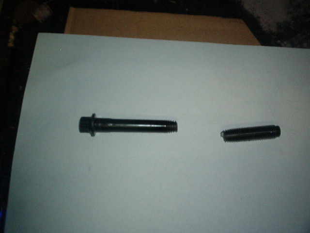

So we get all the bolts in and we start to torque them down in the reuired order when we get to the bolt (intake side) that the piston blew up in #2. So we start to torque to 55 ft pds. The bolt just turns and turns, never get tights no where close. I am freakin out thinking that we stripped it out. So we take the head back off. Threads look fine, bolt looks fine. Put it all back on. Same thing we get the bolt intake side piston #2. We turn and turn, So i am thinking that head is just pressing down cause I have a few other bolts aready tourge to 55 pounds , so we turn and finally it pops. So i am thinking- I'm Fu@%ed here. Turns out the threads where fine and the bolt never got anymore than hand tight at the threads. It must of lost its strenth during the big nitrous explosion.lol . So monday I am going to order all new head bolts.

When you're torquing down a head, bring the bolts down evenly. Do them in the required order, but torque them down in 20lb incriments. Eg: Do all the bolts in the required order to 20lbs, then do them all again to 40lbs, then do them all to 55lbs. You'll end up with a more even crush of the gasket, and no broken bolts. (also... after you're done torquing it down, wait at least an hour... I like to wait overnight, then torque them all back to their fianl torque.)
Also, be sure you're installing the bolts as per manufacturers spec. If they installed them dry, install them dry. If they installed them with lube, or loctite, do the same. Otherwise the torque readings will differ from those of the manufacturer, and you'll end up doing this again later...

in the middle of the post of all the new pictures im thinking, "did this guy order new head bolts?" and then i come across a picture of a broken head bolt, lol, well, they are only liek $45, it probably would have been a good idea to get new head bolts in the first place, but it was aminor detail i forgot to mention, your ALMOST there ! i am too, but i need to wait till monday to get a cylinder head from a junkyard guy

the head bolts dont need to be upgraded, they are perfectly fine, its just that when you take your engine apart like that, you start wearng the thread on the bolt so it doesnt stay as tight, if we all had our way, each time you take off the head, you should replace the head bolts, but no ones perfect
