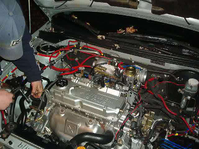

OK-Piston removal-pics!!
Old Nov 11, 2003 | 08:10 PM
agent5568's Avatar
Posts: 169
From: Knoxville Tennessee
Piston removal-Parts back from machine shop!-pics!!
I started teaing into the motor last night.

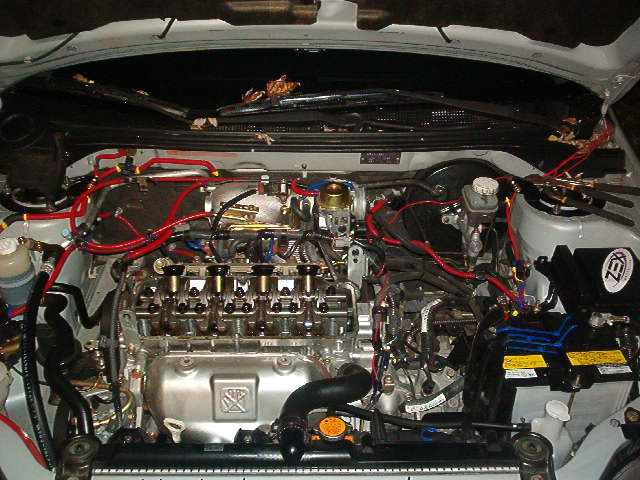

Old Nov 11, 2003 | 08:12 PM
agent5568's Avatar
Posts: 169
Piston removal! Parts back from machine shop!PICS!
valve cover off.

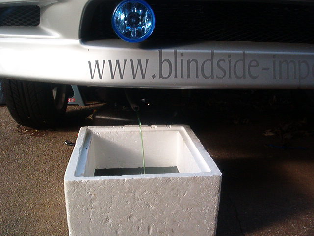

Old Nov 11, 2003 | 08:15 PM
agent5568's Avatar
Posts: 169
after getting everything loose last night. I waited until daylight to finish getting everything ready to pull the head off. I drained all the fluids. lol

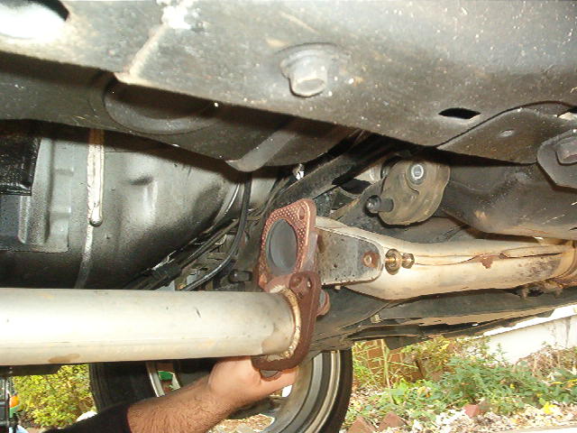

Old Nov 11, 2003 | 08:17 PM
agent5568's Avatar
Posts: 169

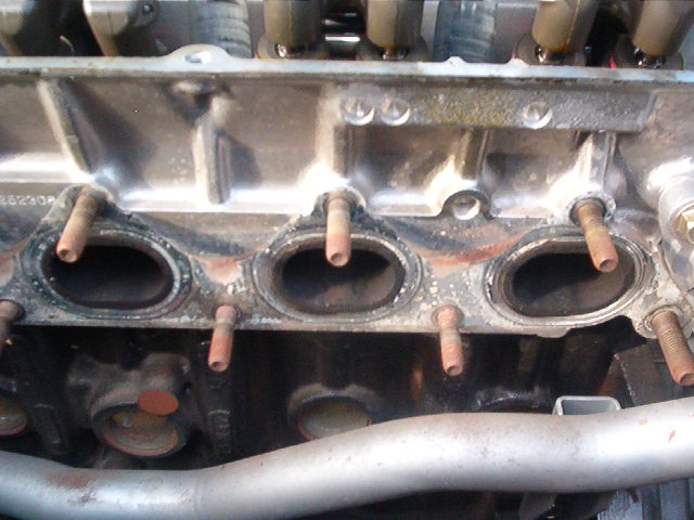

unbolted the test pipe so I could get the manifold off, and move it out off the way.

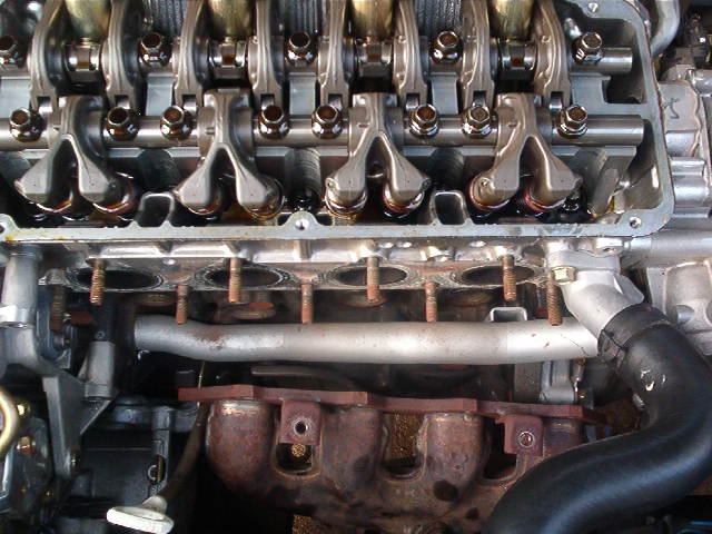

the manifold off and out of the way.

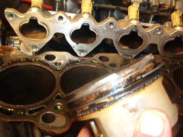

Old Nov 11, 2003 | 08:19 PM
agent5568's Avatar
Posts: 169
Iff you look real close you can see traces of piston. Taking the head in the morning to see if its ok.

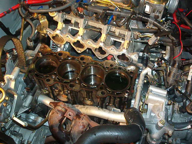

At this point everthings off including the oil pan- which buy the way was a pain in the ***.

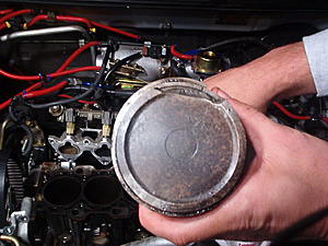

Old Nov 11, 2003 | 08:22 PM
agent5568's Avatar
Posts: 169

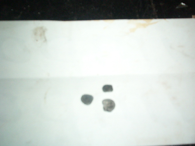

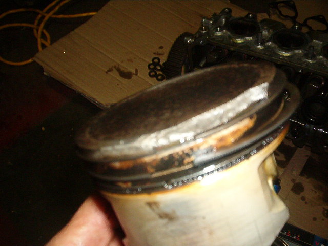

This is what i found in cyl. #2 #3 #4- small pieces of melted metal.
Old Nov 11, 2003 | 08:26 PM
agent5568's Avatar
Posts: 169

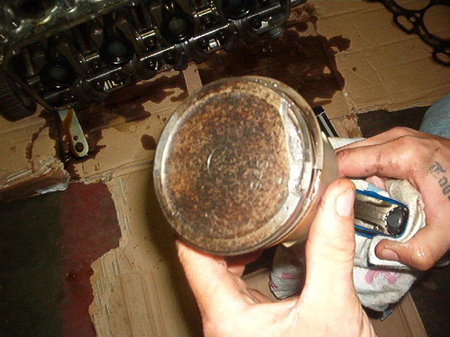

All of the pistons except for #2 are fine- The top side was blown off on # 2 all of the following pics are of the same piston. I was running a 55 shot Zex Kit. I will post the pics of the install in a few days. I am going to take the head to the machine shop in the morning. Put the new pistons on the rods, gap the rings. And put it back together. I might even put the turbo kit on. Depends on the cash.

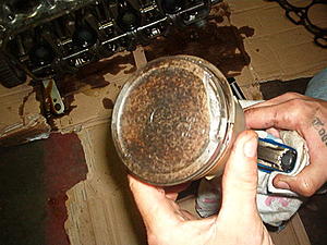

same piston.

that's a nice crack there..are you going forged piston and piston rod now?
Old Nov 11, 2003 | 08:33 PM
tenkawa_akito's Avatar
Posts: 442
From: Roanoke, VA
and this is why we don't play with nitrous j/k
50 shot was supposed to be the safe limit on stock internals, right? are you going to upgrade to some forged parts or replace with stock?
Old Nov 11, 2003 | 08:34 PM
agent5568's Avatar
Posts: 169
I am going with the JE pistons from Road race
