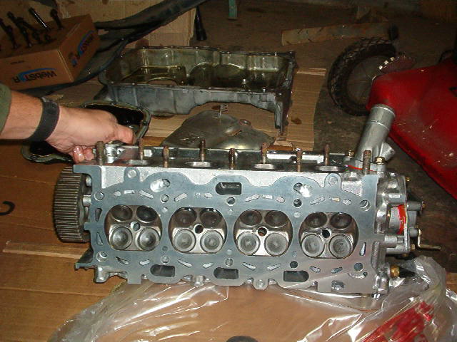

So I got everything back from the machine shop today. The head was decked and .0010 grind on the valves. Everything looks nice. The bearings came in today as well. So now just to put it all together.

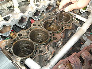

I used a honing tools to hone the cylinders. i only ran it through twice. real quick up and down. it didnt really look like it did very much. Then we gauged the rings.

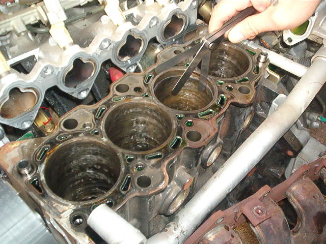

From: Knoxville Tennessee
This took a long time. I checked and double checked. Called the dealership, a few of our friends. Just make sure that we were right.

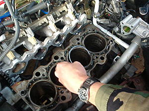

Used a old piston to make sure that the piston was true and level in the cylinder.
