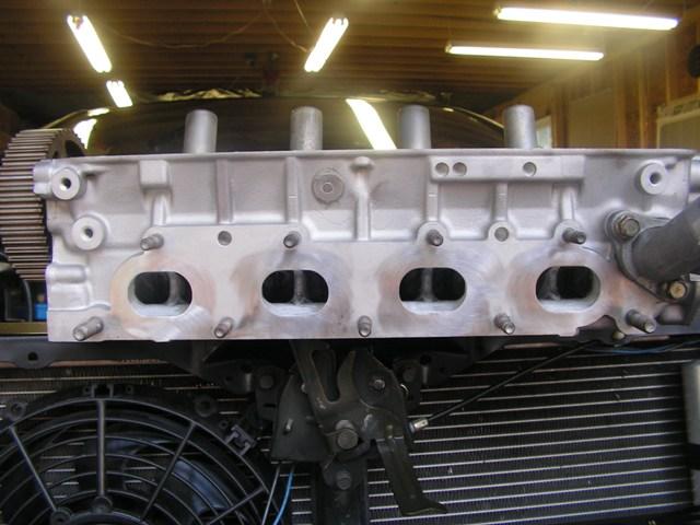

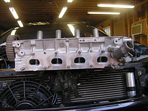

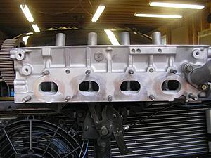

aight, here are the new head shots (haha...get it head shots!....ahhh...I'm so funny )
Attached Thumbnails Engine rebuild time-040102080314.jpg   Engine rebuild time-040102080318.jpg

another

Their lookin nice, gj

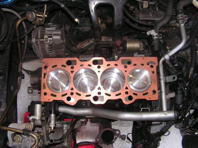

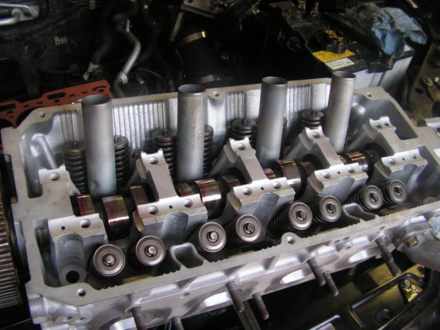

top view of the block with the copper head gasket

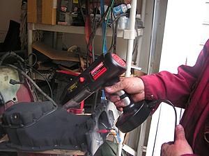

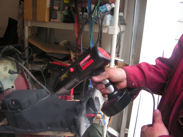

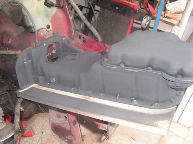

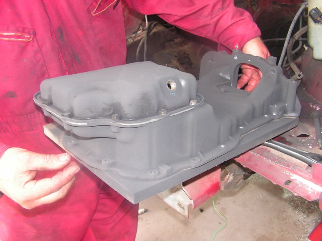

here's my dad powdercoating the oil pan. We gotta do something in the downtime.
Old Aug 22, 2006 | 09:28 AM
  #45
Darklancer's Avatar
Joined: Nov 2003
Posts: 150
From: Somewhere
well, here are the pics of the powdercoating job
Attached Thumbnails Engine rebuild time-040102090242.jpg   Engine rebuild time-040102090254.jpg   Engine rebuild time-040102090328.jpg
