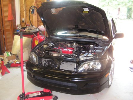

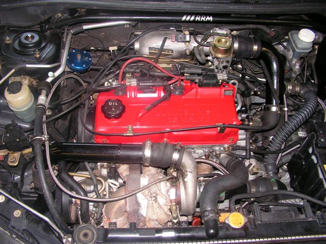

here is a pic of my assembled, about to be partially unassembled, engine.
Attached Thumbnails Engine rebuild time-pict0002.jpg   Engine rebuild time-pict0001.jpg
