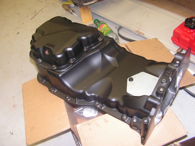

finished product

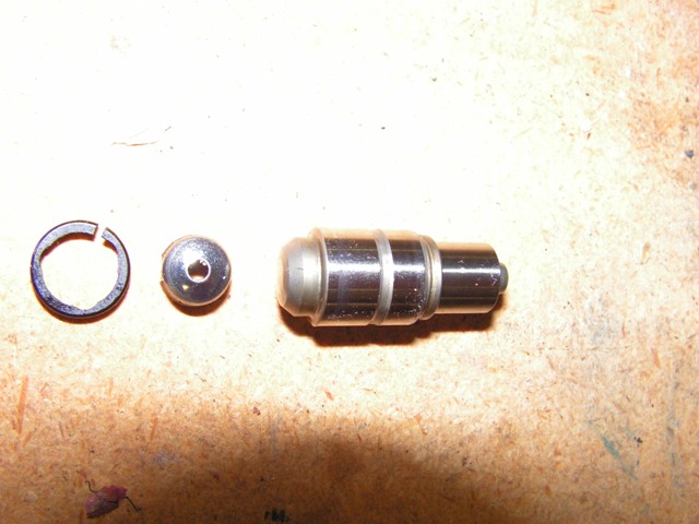

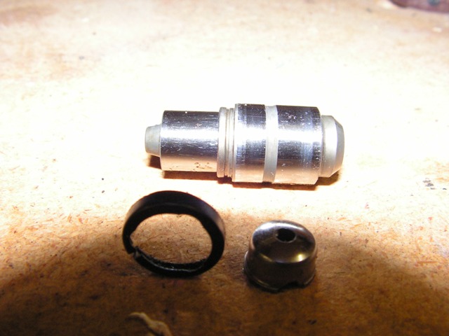

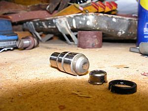

here is the valve adjuster that I have to replace. By the way these things cost 25 bucks each , so take care of em.

+1 on the Powdercoat job for the oil pan, looks nice.
