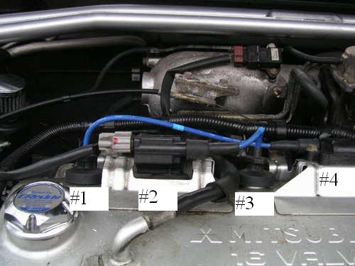

To use his example, see picture. You probably don't have blue plug wires, but you get the idea.
#1 & 3 - just yank
#2 & 4 - use 10mm wrench
If you look down those holes, you'll see the plugs. You need a socket and a long extension. Unscrew and remove. Replace and tighten. Put back #1-4.

omg! it was that easy?! i just had mine installed last night! the only hard part was taking out those two rubber covers! thanks you guys!
