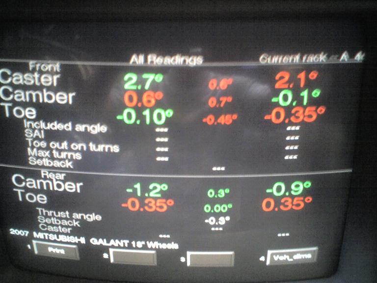

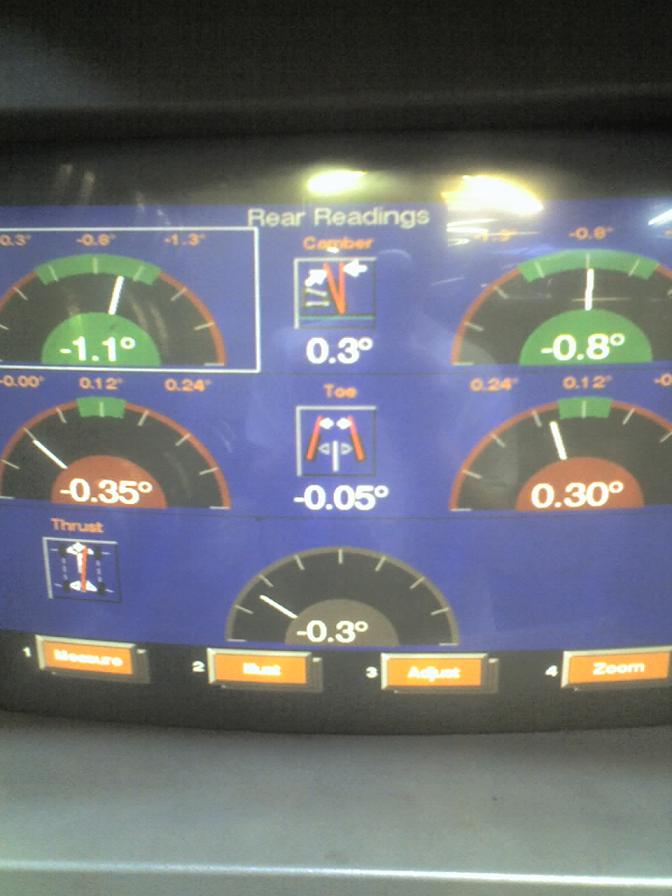

Found out why...
i work part time at a small alignment shop and decided to put my car on and check out the specs finally. So I find that the rear has a big thrust line of about .3 degrees to the left and the front is toed out with a total toe of .45 degrees. The right side is toed out more than the left. When the right tire tries to straighten itself out, it will send the left tire way out to "left" field :P Thus the little wander we all find to the left. I will attach some pics and will let you know if the dealer fixes it. If not I will do it myself and set it up how I want the car to preform.
I know not everyone has the option of doing this themselves but I thought I would let you guys/gals know of what I found. Also this is only with 6000Kms on my car. Its definitely factory settings. Anyways hope this helps.
Also look at the front left camber....its positive...eeek.
I wish my new shop had an alignment machine! I always did my alignments on a nice Hunter machine.
I don't see toe causing much of a pulling-issue though, but that thrust line could be a major concern. How was the front caster when you hooked the lancer up to the alignment machine? Is our caster/camber adjustable from the factory, or do we need a kit to mess with any of that? I would love to see some specs on the 08 lancer. I can't believe everybody is having such a big issue with this pulling to the left problem. My 2008 Lancer (DE model, keep in mind) has no pulling-issues, and I am very impressed with the factory alignment. I have always been told that the factory alignments are not the greatest thing, but they should not be this bad.
Since my DE model has no pulling-issues, I wonder if it has something to do with the factory tire on the GTS model? The tire on my DE (205/60R16) is a Yokohama Avid. The GTS comes from the factory with a Dunlop SP Sport 5000 M tire (215/45R18). When I worked back at goodyear (Dunlop is a goodyear tire), I remember having some problems with Dunlop sport tires. I wonder if there will be a possible recall on the tire, or the factory alignment? Rotating the tires hasn't helped some of the Lancer guys though. Hopefully Mitsubishi will resolve this problem soon. Good luck with the petition.
I'd like to hear from some more DE/ES guys though.
I didn't look at the front for adjustments other than the obvious toe, and the rear has one adjustment which should effect toe and camber I think. If the dealer doesn't fix it then I will just tweak it myself and see if I get any better results. It may take me a week or two to get this done so hang tight guys.
