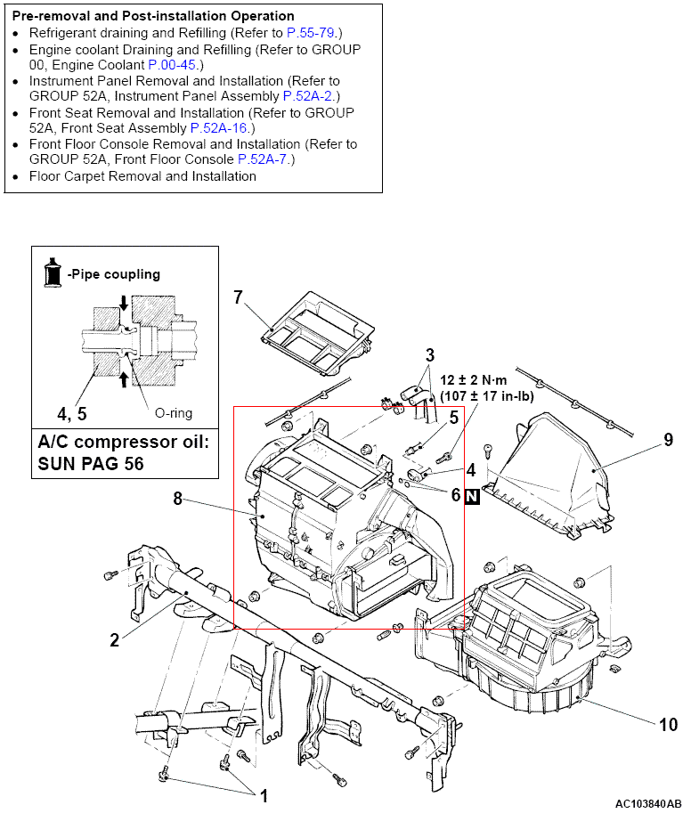

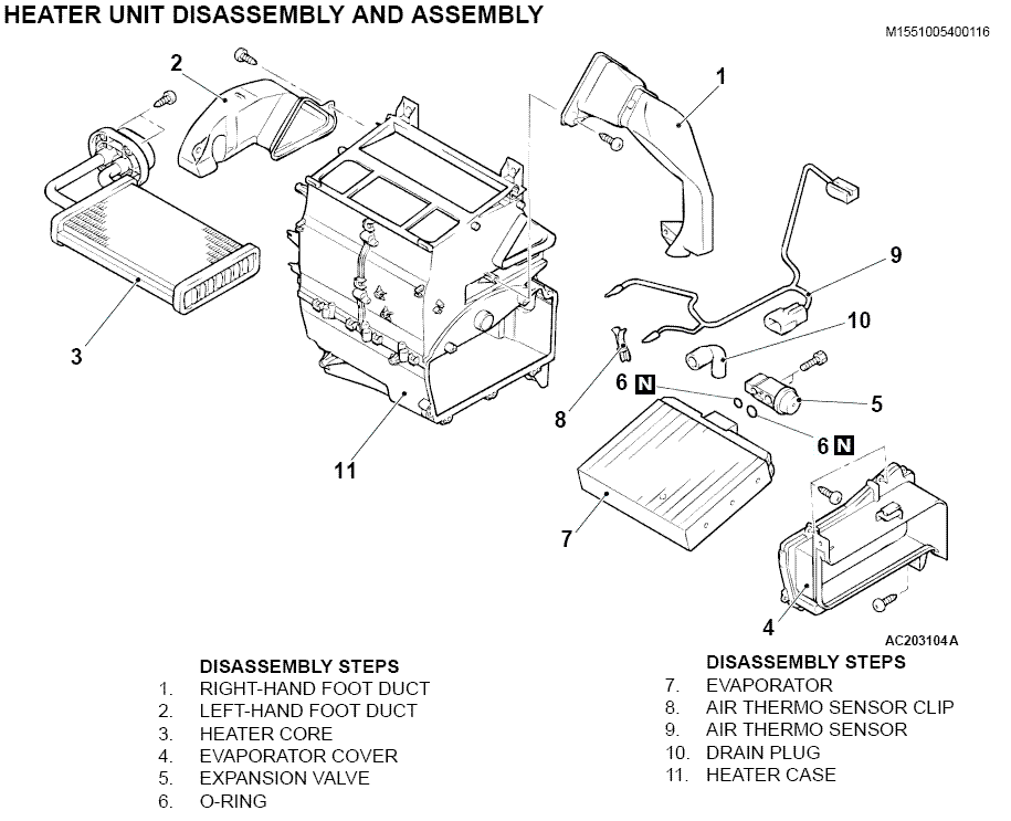

The evap core from a Mirage will NOT fit. You can use any evap core from any 02-07 Lancer or 03-07 Evo. They are the same part. Here are some pictures to give you an idea. The evap core is located inside the heater unit. You WILL need to take apart your entire dash to get to it. Sorry.

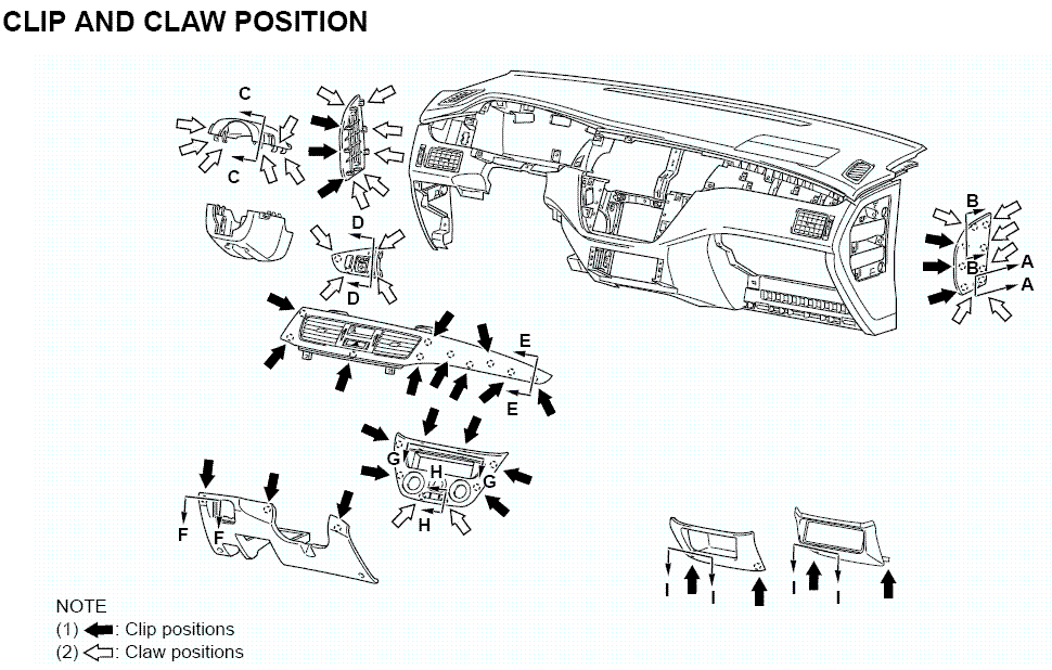

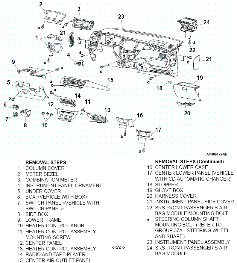

MR958417 is the part number for the evap core. Here is a diagram of what you need to take apart.
