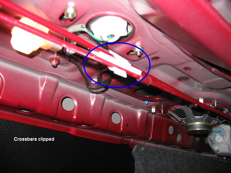

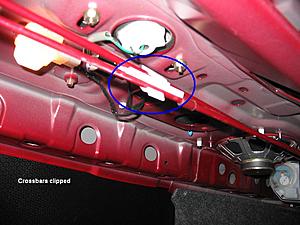

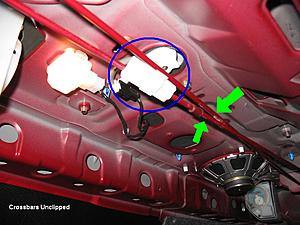

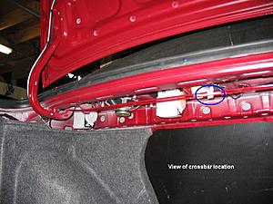

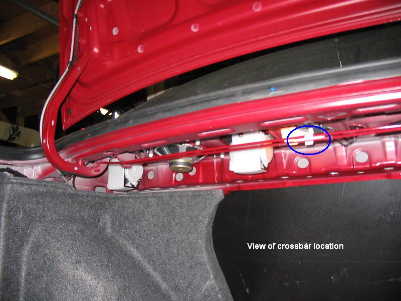

Im bringing this thread back to life simply because I have a solution to this rattle problem.
First off: Hotshot, I have no idea what the hell youre talking about when you talk about this "Auto Lock System". There is no auto lock system, its a simple trunk with a simple latch. What made you come to a conclusion that it's an auto lock? And also why would it rattle?
And now to the solution: there are two cross bars on the inside of the trunk (not the trunk lid but the actual trunk) They go across the top of the trunk and are about the width of pencils. If you look theres a white thing in the middle of the bars. If one of the bars isnt connected to the white piece then clip it back in. There, you're done. You should have no more rattle.
If the two crossbars are connected to the white clip and it still rattles, then I have no idea whats wrong with your trunk and you will die poor, lonely, and annoyed by the rattle of your car.
Here are some pics of the crossbars (blue circle = the clip, green arrows = crossbars)
