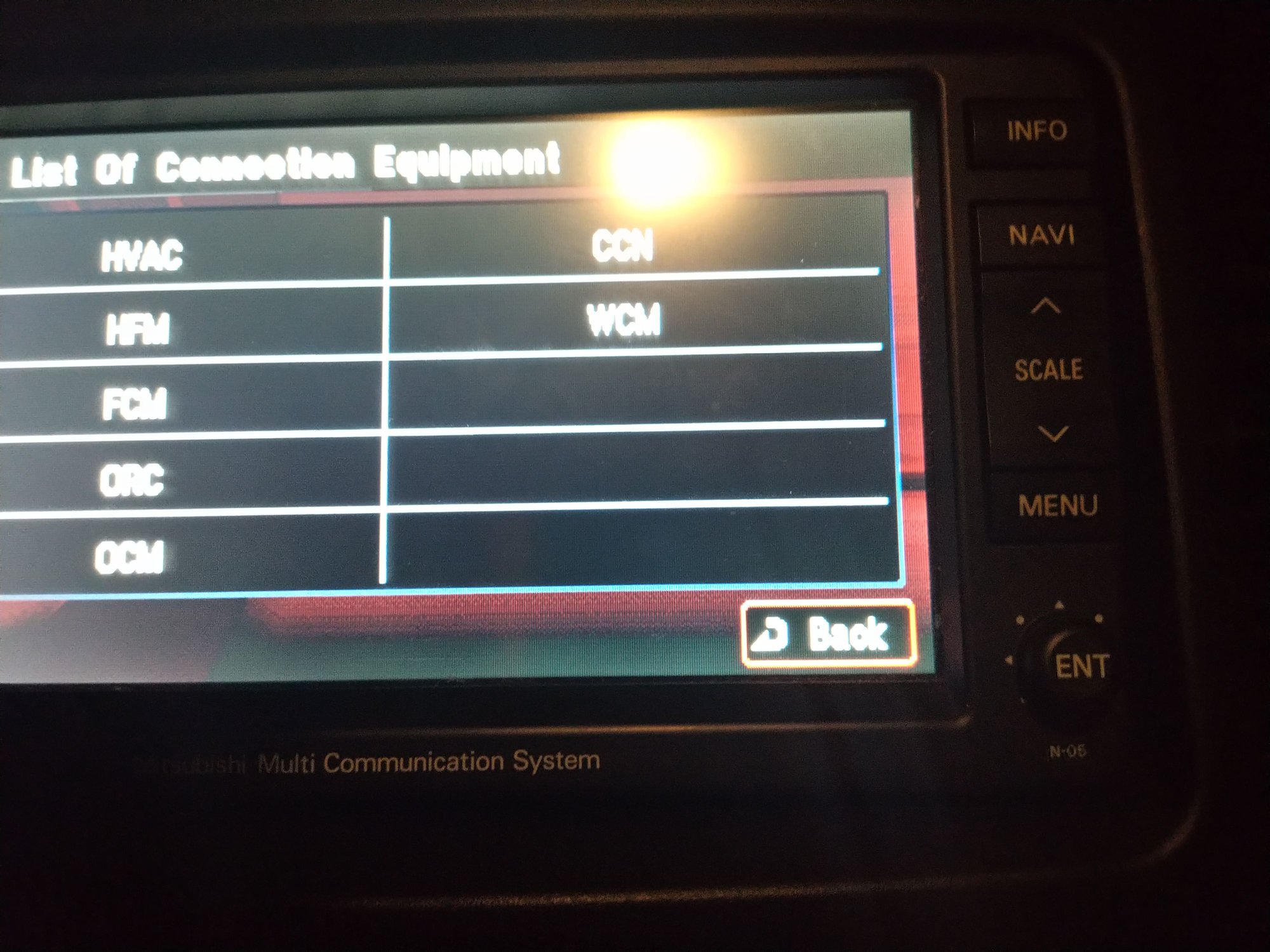

New update 1 Feb 2019
CAN connected equipment
Service Menu
So I got the mini-VCI, paid for a server request on ETACSdecoder, and changed the following 3 settings:
AUDIO: present --> Not Present
AVN: not present --> Present
HFM: not present --> present
After restarting the car, the CAN unit now detects the HFM. Unfortunately, the N-05 MMCS unit still has the Hands Free Module / USB BOX greyed out.
What am I missing? It detects the dang thing when the factory stereo is installed, but tells me to bork myself when the NAV is in.
I suspect this forum is pretty much dead, but I am hoping some kind soul spots this and gives me a suggestion.
Edit: Found the issue after going back over another post here: https://www.evolutionm.net/forums/evo-x-electrical-audio-security/581300-did-i-just-screw-myself-3.html
user @ericjai113 had the exact same issue and after purchasing the correct harness it fixed the issue. Sadly, they posted a link to the part, but not the part number, and now the link is dead.
Regardless of what the jackwagon at the dealership said, 8755A020 is NOT the same as 8755A055. Turns out that A055 was made specifically for the 2011 2012 Lancer for the express purpose of connecting the FUSE system to the N-05 MMCS unit.
I do not have the cash right now to get a new harness, so I am gonna dig for wiring diagrams and see if I can manually add the missing wires to the A020 harness. If I could find service manual page 54C that would be awesome, but that thing is like a bigfoot riding a unicorn for some reason.
On the upside, changing those settings in the ETACS also fixed the "right side only" audio problem from the HFM when the 1CD factory stereo is installed.
Service Menu
Edit: Found the issue after going back over another post here: https://www.evolutionm.net/forums/ev...-myself-3.html
