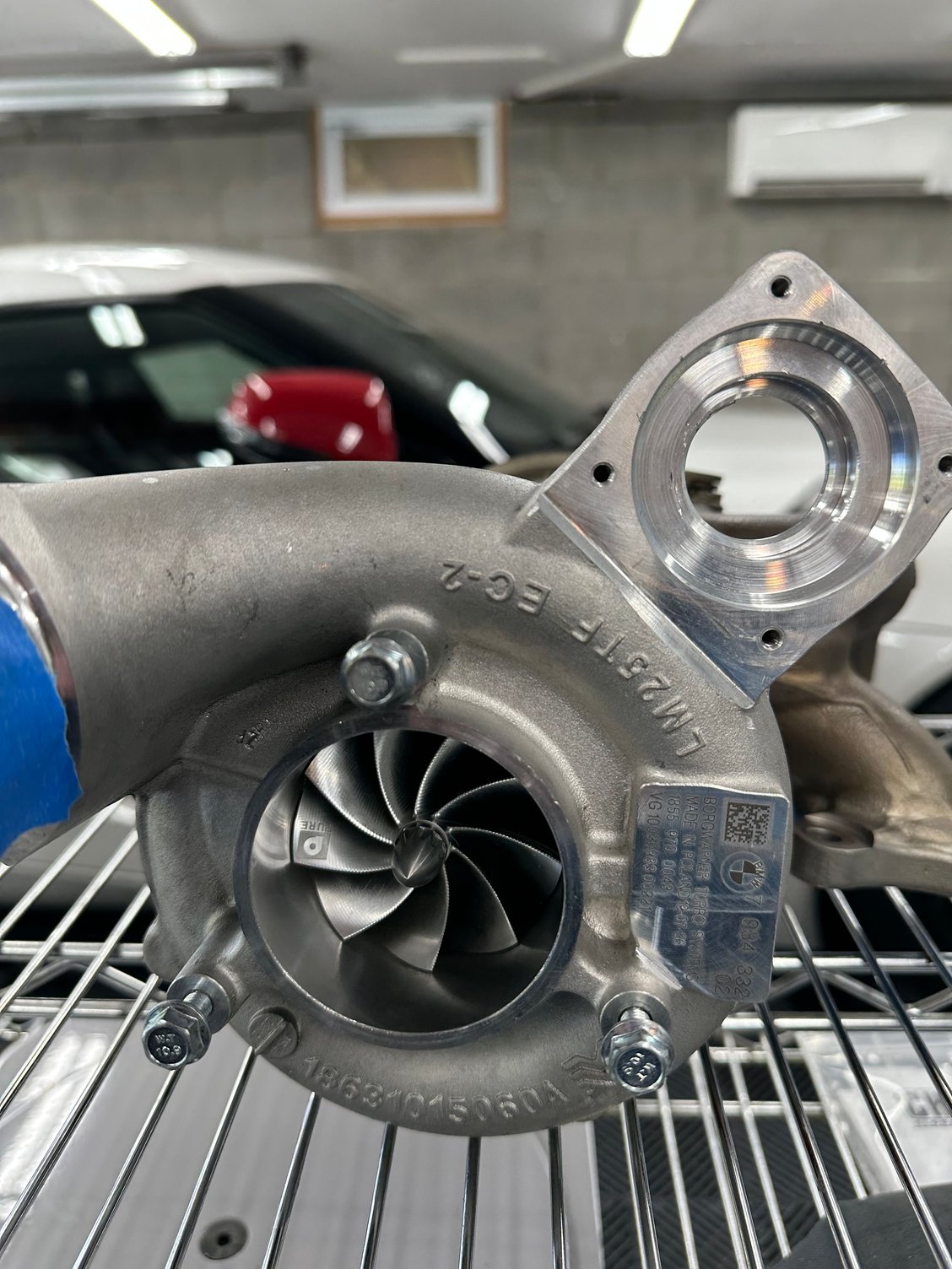

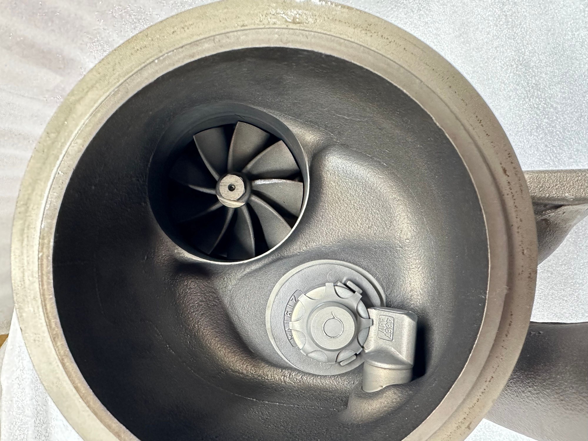

Originally Posted by Jaraxle
What about OEM turbos but with replaced wheels?
That is what I was/am running. Pure takes the OEM turbo core and bores it out and stuffs bigger wheels in it.
Back when my Pure700 was all in one piece:

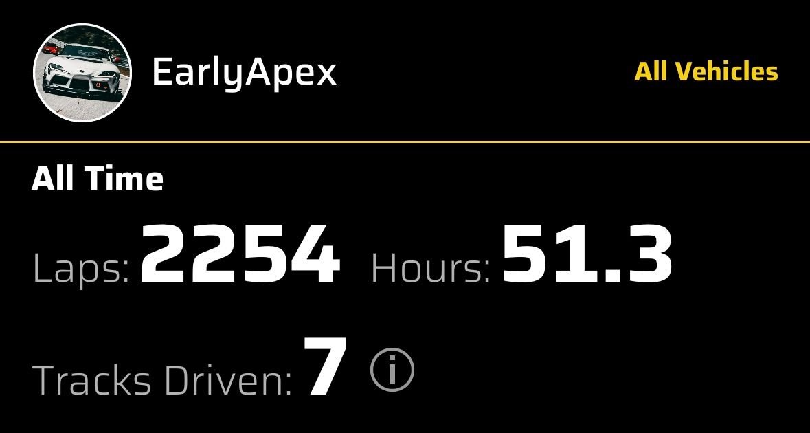

There is nothing wrong with Pure Turbos. Bryan has a lot of laps/hours in his car at the track. Parts fail occasionally, it's part of track use/racing.
