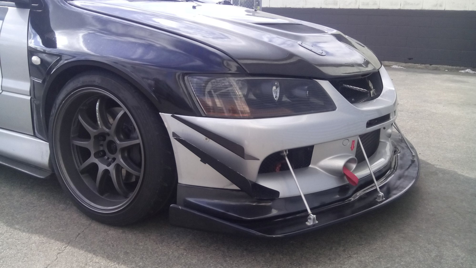

Originally Posted by killerpenguin21
i sent a message to a guy in
by them for a bit...ill let you know when i hear from him.
on another note:
CANARDS - anyone run them?
im interested to try some just to finr tune the balance of my car at this point, but cannot find any.
i had talked briefly with wasp composites over the summer because i know they made sets in various styles for both Zhong in CA and the orange evo that john carson drives in GTA. at that time they told me they had no molds readily available but could look around the shop and potentially do a one off...i never heard back.
password jdm make carbon pieces for various cars including the evo x and s2000. ive thought a few t imes about buying a set and seeing just how much work it would be to get them to sit nicely on the bumper.
Dave Kern has run multiple sets, and i believe they were probably DHP...i recall him having a relationship with them.
anyone have any ideas?
This is how i have my car set up currently. Custom designed. Sorry have no wind tunnel testing or anythn for them.

did you make them yourself?
what splitter is that? are you happy with it's performance? i plan to build a rear diffuser and am thinking i may need a splitter to balance things out.
you can probably get away without a splitter if its just stock wing and diffuser. i believe thai (honda-guy) was able to back his wing down a notch or two when he put his splitter on.
im running a 5 inch splitter, and i need more front bite...
