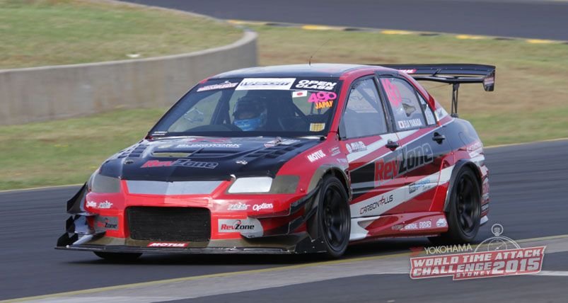

Whoa, that front looks a lot like Tilton's car...

An American WTAC build Been pondering getting into fiber myself but like you said it take some years to master.
