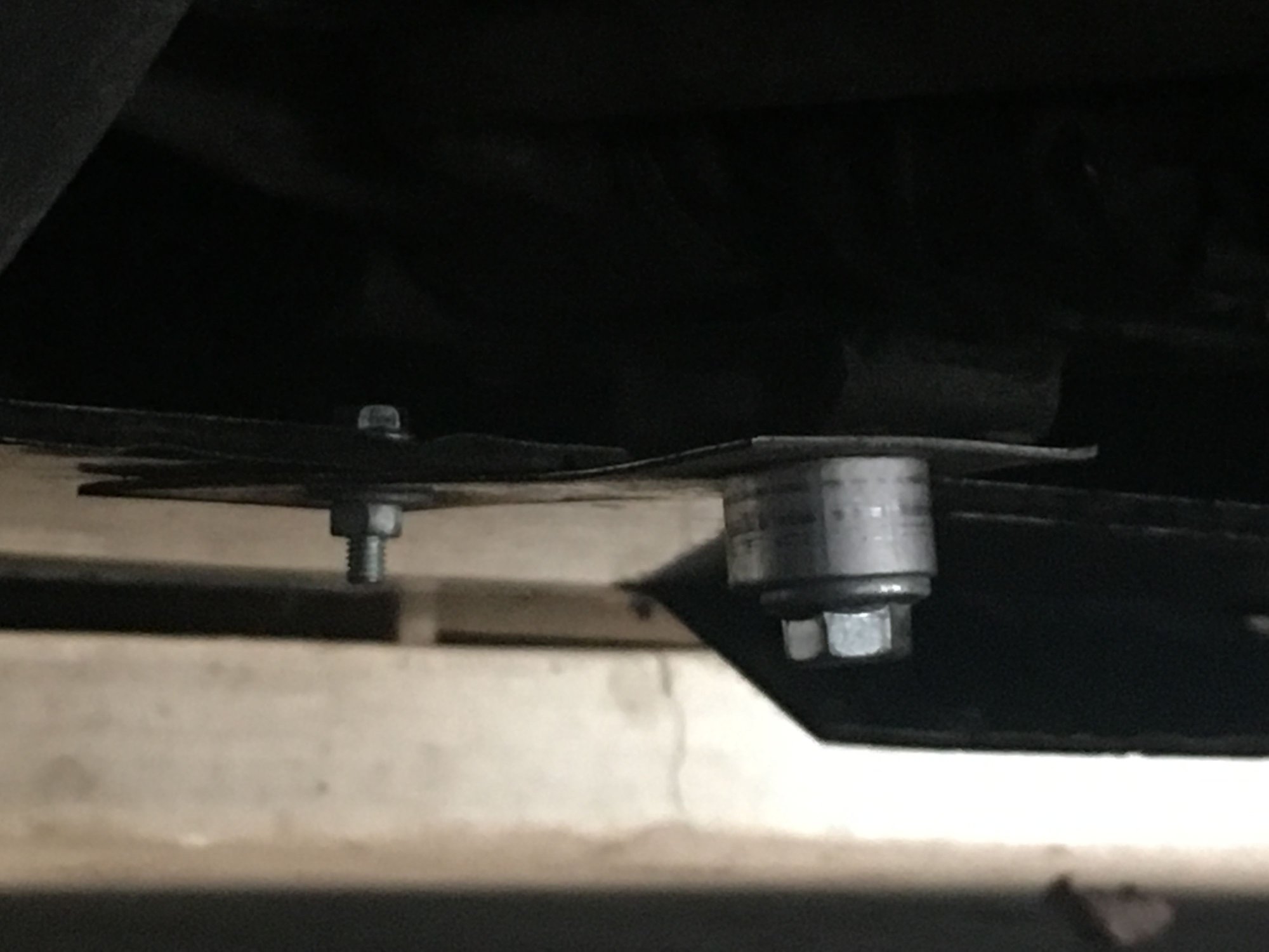

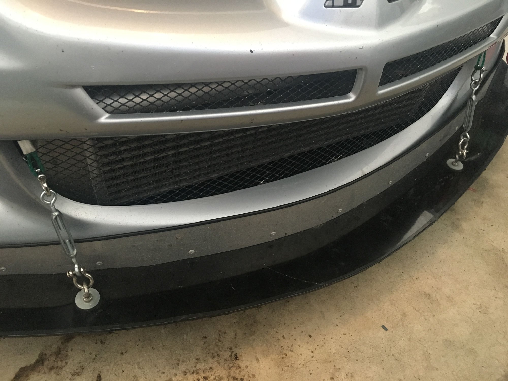

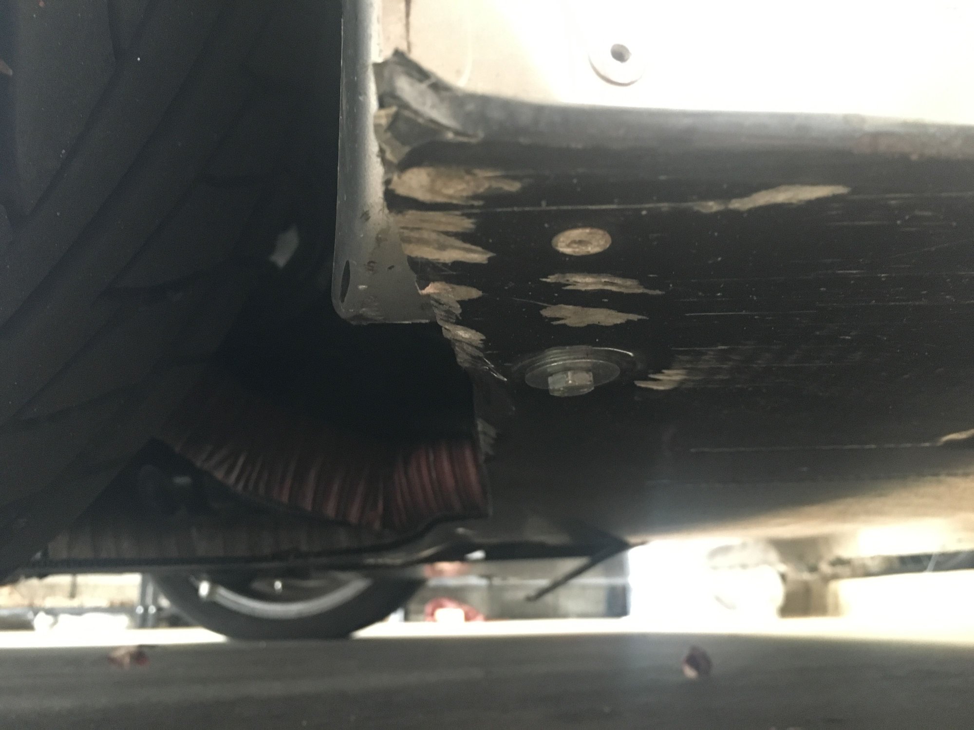

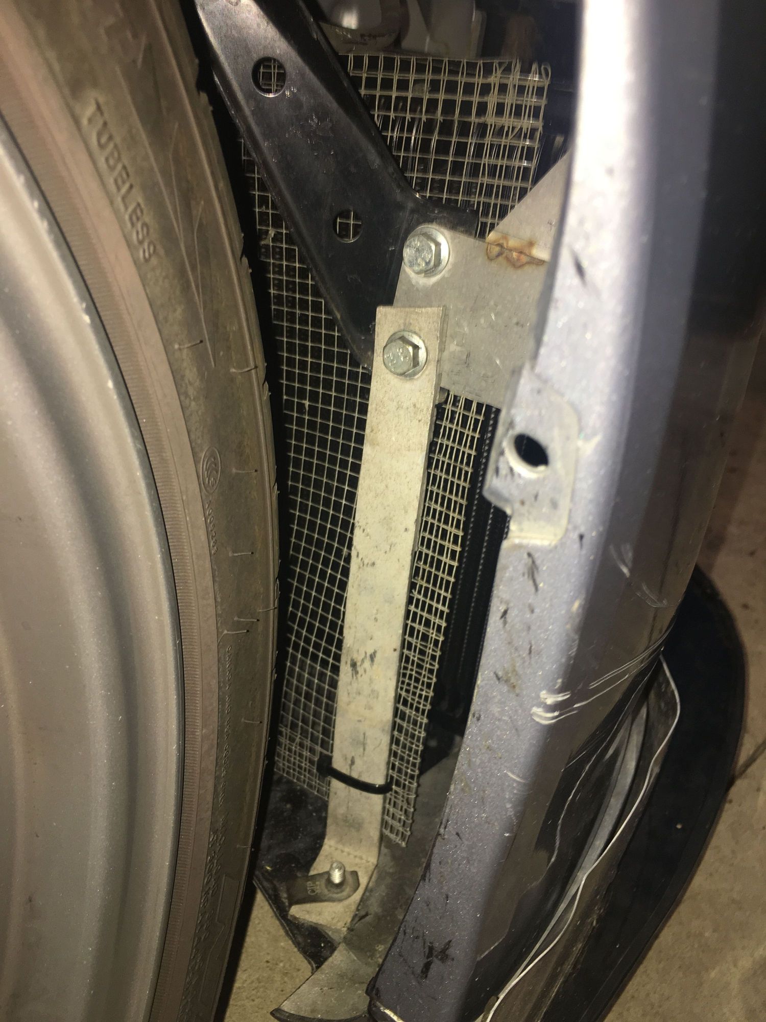

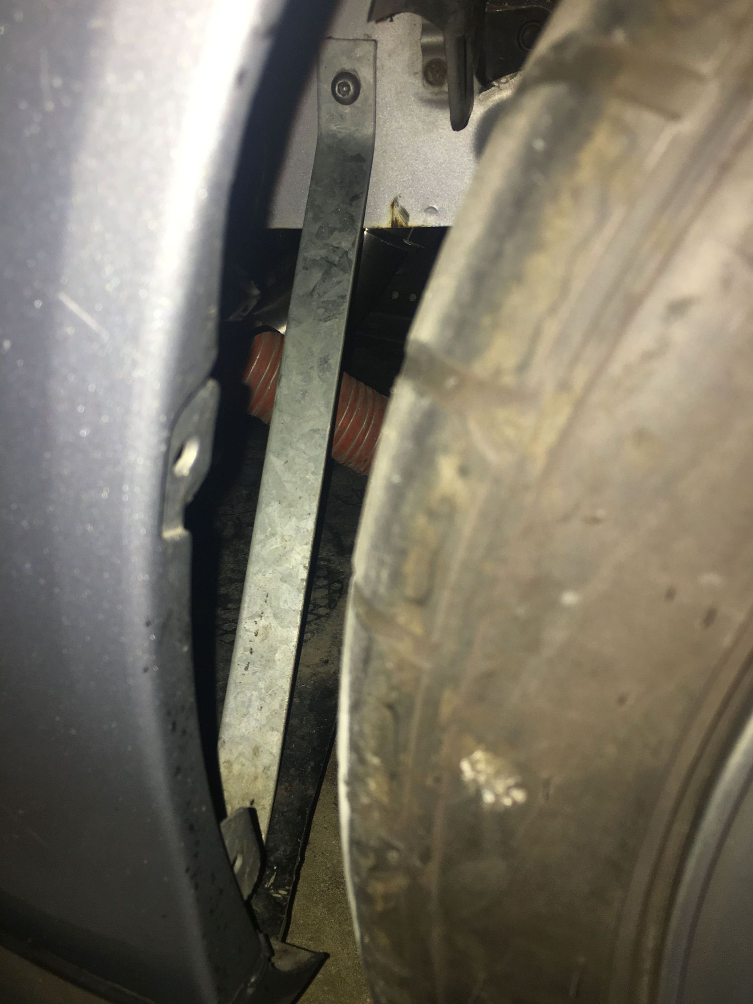

Okay so here's how my splitter is set up. Two cables in the front, adjustable with turn buckles (think I'm going to change it over to rods this winter). The cables are fastened around my tubular crash bar.
Two brackets to connect to the frame rails. Driver side goes straight to the frame rail, passenger side connects to oil cooler bracket that's connected to the frame rail. Bolt on the bottom goes through the splitter and the bumper cover before threading into the nut clip on the bracket.
The last two attachments are 3" side aluminum tabs that are bolted to the rear of the splitter on one end and to the east west bolt hole locations in the subframe on the other. Couldn't really get a great pic of them without jacking the car up. Ignore the spacer under the bolt head, I'm not running the east west brace right now, they're just there to help it clear the downpipe normally.

That's not bad at all. And I'm glad to see a fellow plywood splitter maker LOL
Lol it's a ****ty pic. It's alumalite, very very beat up alumalite. Might make a new one this winter if I can get a sheet cheap enough.
